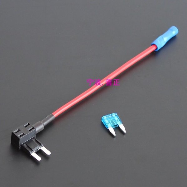

    Use a circuit tester and find a circuit that's always hot in the fuse box on the lower/left of the steering wheel. You can tap into one of them with one of these:
