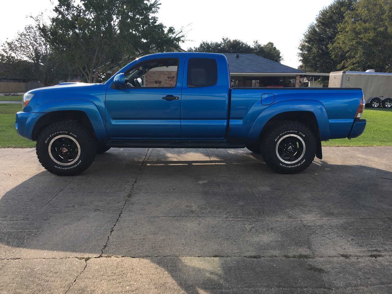

    Finally got my lift installed. TRD Baja front shocks.

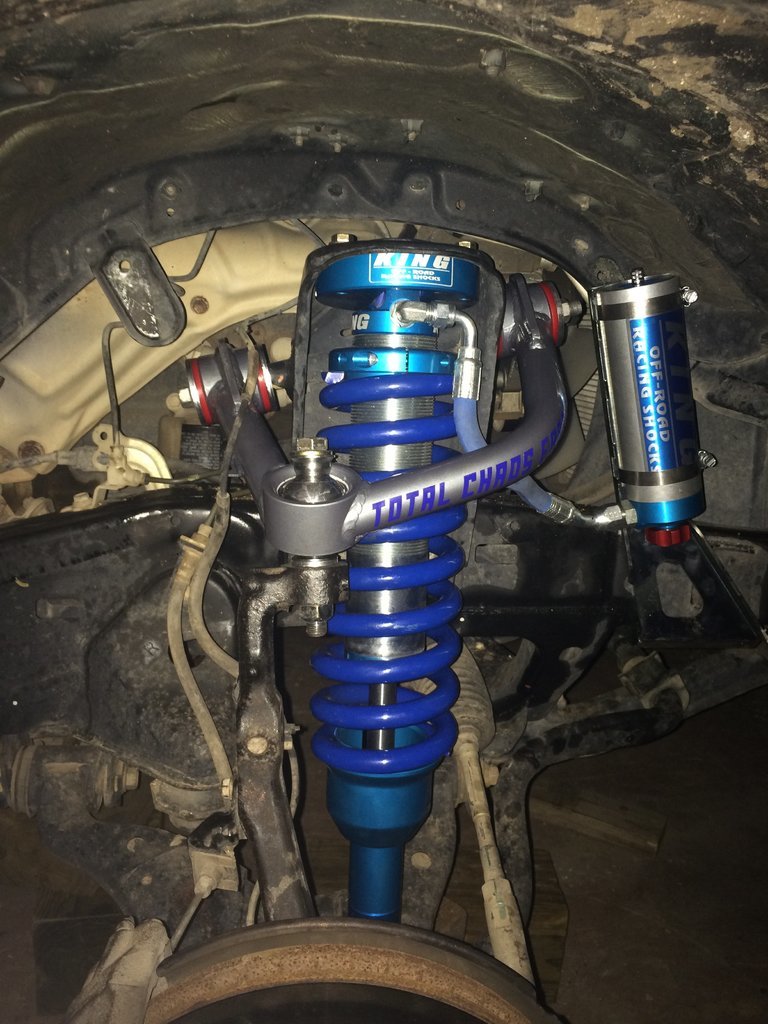

    Forgot about this thread after i lifted mine a while back. Im running king ext travel coilovers w/ the 700lb springs on the amount of preload that they were sent to me with. Ended up with about 3.5 inches of lift up front. (I have a 2.7L prerunner w/ 5spd)
    Heres a pic to show how much preload is on them

  12. Sep 26, 2017 at 8:36 PM
    #572

    How's the ride up front?

    Its pretty firm on washboard roads at low speeds, but it eliminated the nose diving i was getting when i have to brake hard when traveling quicker. Once you get up above 15-30mph off road, it soaks it all up and rides like butter. It should only get better as i add a winch, sliders, and other weight to it. Im pleased with how it rides and i figured itd be much easier to just lessen the preload if i wanted to lower down the front if i needed to smooth things out. i didnt want to try and add preload to them since from what ive read its a total pain in the ass, and id rather get the lift from the springs versus preloading the hell out of them.
