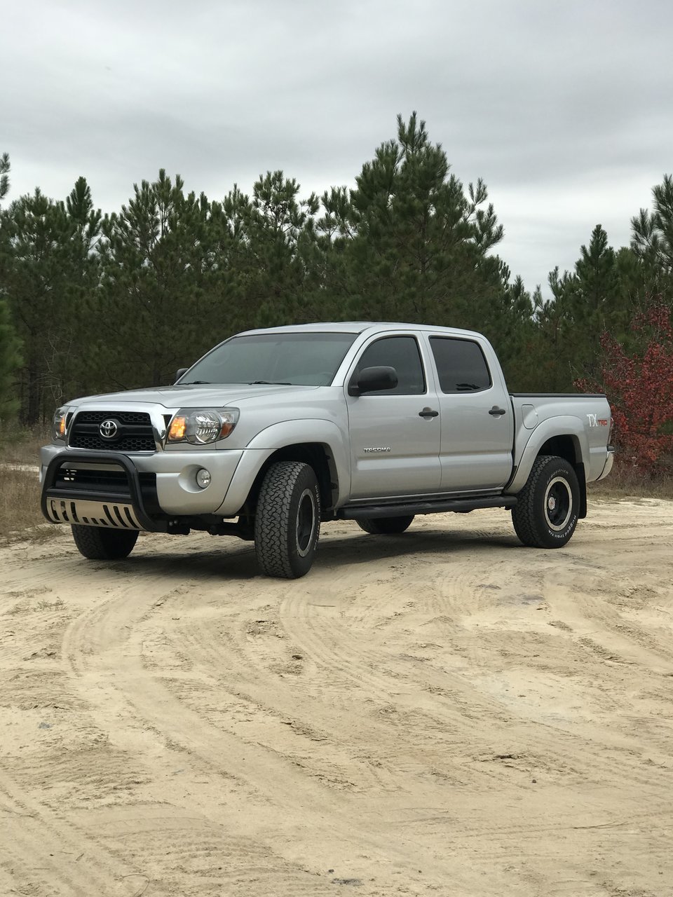

    Hey guys, scrolling through I see a ton of great looking 2wd trucks but no description of the lift! I’m looking to get mine up 2-3” but unsure of the best way. She’s mainly a highway rider, but every once and a while I might do some light trail rides. Any suggestions? Through my research I’ve seen that sometimes going with billies, coils, and leafs can make the truck ride hard which I’m trying to avoid. I’ve talked with Marie at Headstrong and she’s given me several ideas, but I’d like some actual feedback!
    Here she is stock (minus the bull bar)

    Whats your budget?

    Keeping it under $1000.

    planning on adding any armor or any other source of weight to the truck? does 1k include labor or are you doing that yourself?

    Wasn’t planning to add any weight to the truck. I know Marie from HeadStrong had mentioned spindles to avoid that issue. I’m hoping to do it myself/with help.

    If you dont plan on doing a 4x4 conversion, spindles is def a good option. You get 4 inches of lift and dont need UCAs to keep your alignment in spec, the downside is youll need to spend on some expos or dakar rear leaf packs and extended rear shocks, or get blocks to level the truck out.
    The other option for your budget is bilstein 5100s all around, 885 coils up front, add a leaf in the rear.

    Yeah, I do regret not purchasing a 4x4 from the get-go, but I won’t be doing any conversion on this one. I’m trying to decide between the spindle/AAL option and the 5100s/coils/AAL option. At what point would I need to upgrade the UCAs? I’m Not sure which lift would be better, but I think if i go spindles that I’ll drfiinitely have to upgrade from my 265/70/16 tires and im not sure how long that would take to purchase on top of the lift.

    well, I have some assembled front 5100s with 885s, 35-40k miles for sale.. if it helps any. 150 shipped?
    coil option will ride better than stock, but spindles will keep your alignment true without UCAs, plus an extra inch of lift

    That’s a great price. 885s provides 2” or 3” if lift? Is it a for sure thing that I’d need UCAs if I go the coil option?

    i didnt have UCAs but my my alignment wasnt perfect, id get UCAs and do it right the first time. 3 inches on a prerunner
