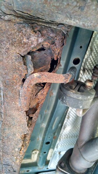

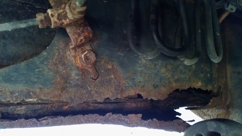

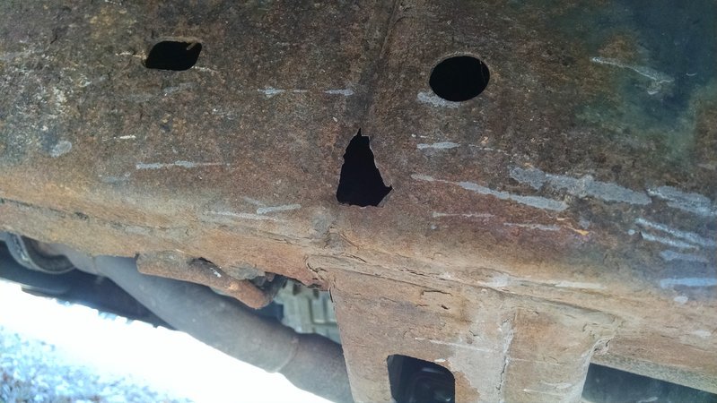

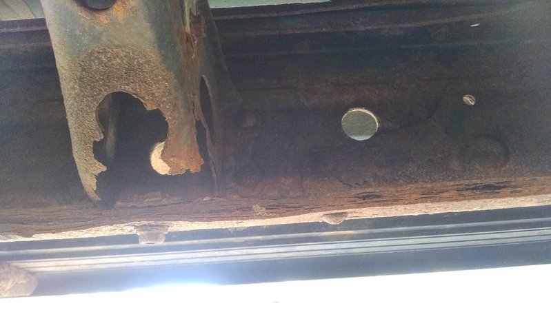

    What's up Community. New Member and First post here.
    Been searching around for the last year or two about the rust settlement and just got curious...
    What's everybody else's look like?
    Frames that is..:thumbsup:

    Wow, that rust is crazy..... makes me glad I don't live in the northern states or near the beach.

    The good news about rust is that it can all be repaired. It's a pain, for sure, but if you take your time, and work skillfully even the worst problem can be repaired. You may choose not to do it for any number of reasons, but it's metal, and a good mig welder and some new panels, patches, and parts can fix it.

    Holy shit.....is all that real?!?!
    Note to self....don't go North. Also, are you getting the frame replaced under warranty?

    There is NO way that frame is economically salvageable. No flipping way. Yeah, ANYTHING can be fixed with enough time and money...but we arent talking about a 63 split window Corvette here...Fixing that frame will cost more than replacing it.

    Absolutely--but if the OP qualifies as a class member in the recently settled Brian Warner et al v. Toyota USA suit--paying for it will be on "Toyota's dime". And you can bet that as we "speak" they have an army of accountants working on how to best expense and amortise the cost of the frame replacement program agreed to in the settlement; so as to minimise its impact on the bottom line...

    Yes I'm waiting on the go ahead to bring my truck in. I've contacted everyone I can about the settlement and they've all said, 'we have your info on file and will contact you'...
    We'll see.

    Holy shit man. I would be afraid to wheel that thing until it was a little more reinforced/repaired frame. I couldn't imagine if my truck just broke in half on a trail.

    I would hope I fall under their '10mm' perforation..Lol.

    It's been like that for year and a half now. Last year I put 38,000 miles on it. All over east coast, north-south.
    It definitely takes a toll on my nerves, wondering if the next pothole is gonna send me in the ditch or not.
    Honestly, this truck rarely sees a dirt road just for the sake of that frame.

    Oh ok cool, just checking out the pics made me cringe a little as your condition is quite significant. With the size of those holes, I hope that Toyota makes you priority to get done.
