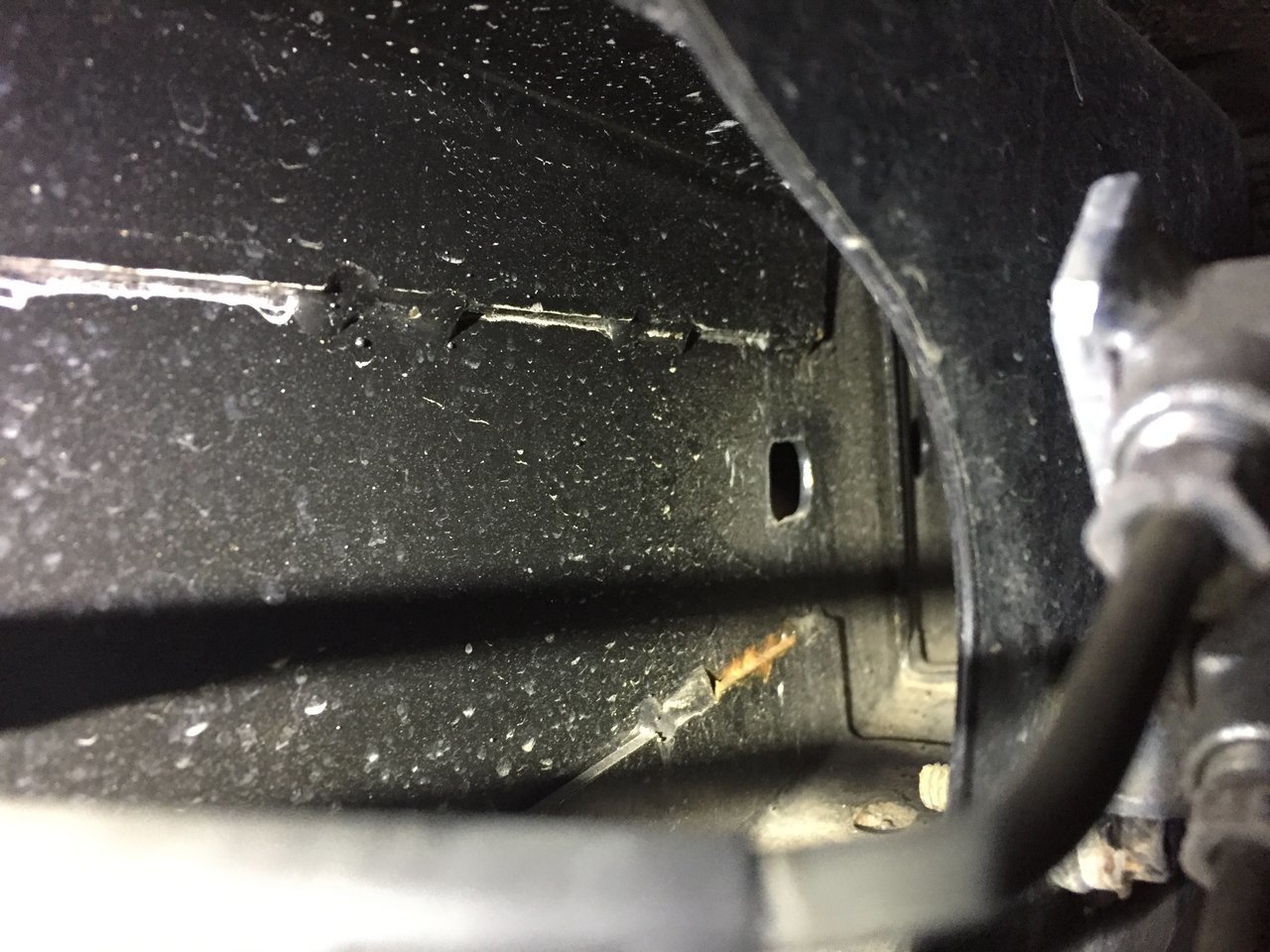

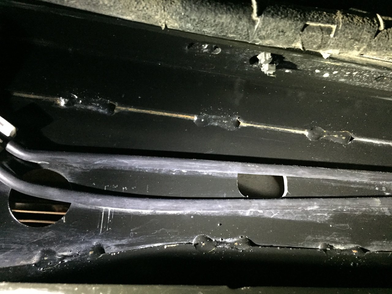

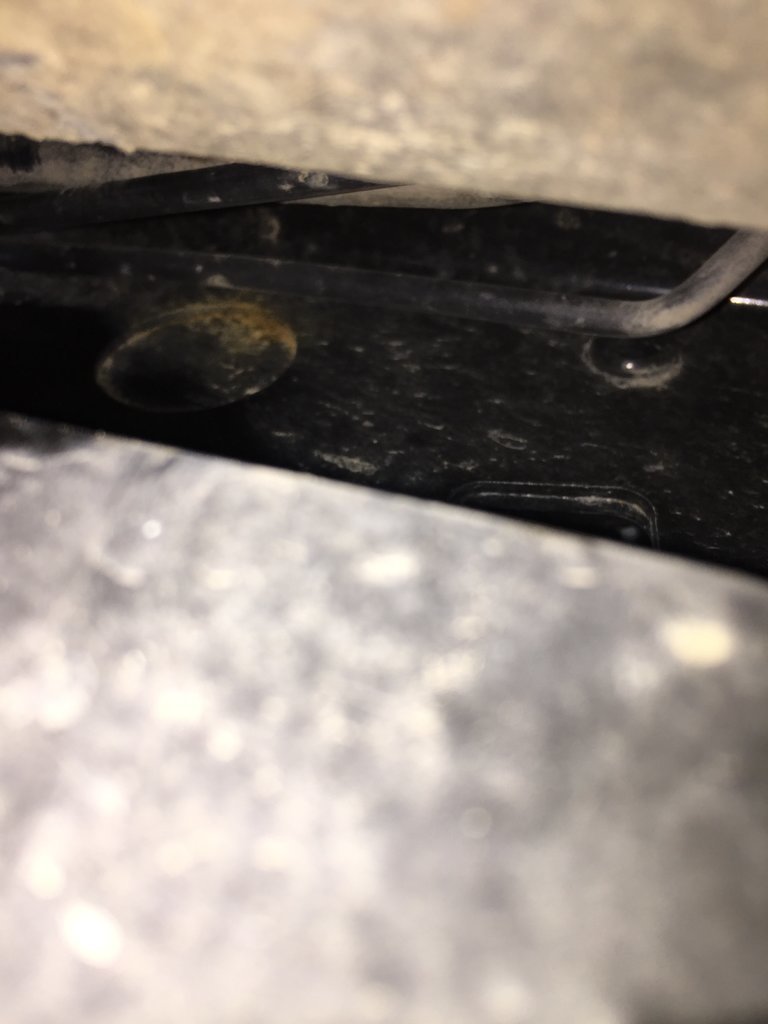

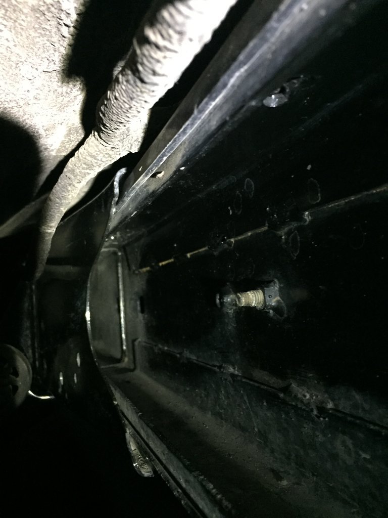

    Extra Frame Rust
    IMG_2568.jpg IMG_2567.jpg This is my 6 month old frame. IMG_2560.jpg IMG_2573.jpg
    See how it starts from between the layers.

    ("Toyota has received reports that certain 2005 through 2008 model year Tacoma vehicles operated in specific cold climate areas with high road salt usage may exhibit more than normal corrosion to the vehicle’s frame. Toyota investigated these reports and determined that the frames in some vehicles may not have corrosion-resistant protection sufficient for use in these areas. This combined with prolonged exposure to road salts and other environmental factors may contribute to the development of more than normal rust in the frame of some vehicles. This condition is unrelated to and separate from normal surface rust which is commonly found on metallic surfaces after some years of usage and/or exposure to the environment.")
    My frame was rotted through 9 years 3 months after being delivered into service.
    Toyota still has not changed a thing in there manufacturing processes soon the 11-15 will get the same announcement. it is un acceptable in this day in age that Toyota is still producing these frames with the same defect. there is plenty of coatings on the market that could be factory installed that would prevent the corrosive salt water on our roads from getting between the layers of metal (where the metal remains un coated). preventing these frames from rotting from the inside out. the rust starts between these layers. it is near impossible to clean between these layers due to the fact they are tightly fitted. If the lineal edges and stich welded areas were filled with a malleable, paintable or rubberized coating before being dipped in the final coat. these trucks would last a long,long time. but Toyota is cheep and refuses to spend the extra 100 bux in the manufacturing presses. Toyota owners get the shit end of the stick.
