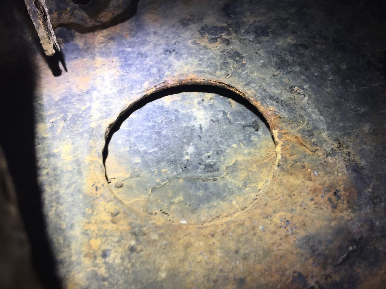

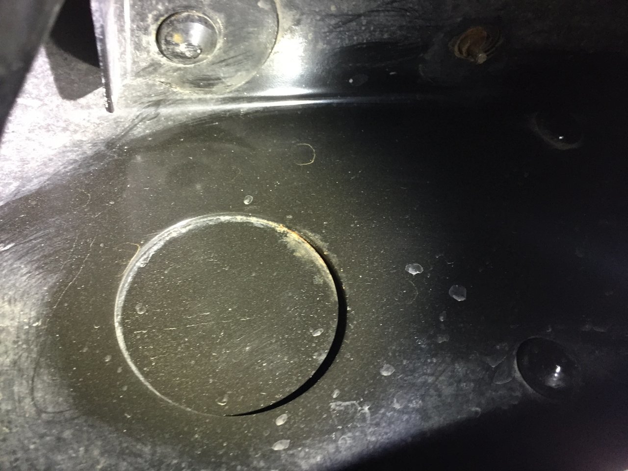

    Met a fella at the grocery in store parking lot, look at the swelling to the rear end of his frame There is almost 1/4" gap Compared to my (new 6 month old frame)IMG_2647.jpg IMG_2638.jpg
