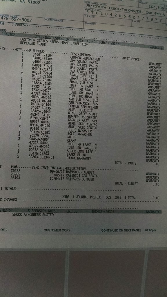

    So they replaced my rear shocks for free, and did everything they were supposed to. I found a couple trim bolts/pins missing but other than that it's golden.
    The steering is ALOT tighter. New lower control arms with bushings and cam bolts, brake lines, engine mount bolts, and other miscellaneous bolts that broke.
    I found I need a new carrier bearing but after searching high and low, I can't find much else other than needing some aftermarket control arms to compensate for my lift.
    Loving It.

    Brought my truck back to the dealership today. They plugged in the driving/fog lights and adjusted the rear brakes. All is now well.
    Talked to the two technicians who performed the frame swap. I shook their hand and thanked them for their hard work. They told me frame swaps is all they do, 14 hours a day, 3 days on 3 days off. And I chastised the service manager about the filthy dirty condition they gave it back to me. He said he's trying to get the dealer to authorize a P/O to add to the work the send the truck out for a wash. He said the salesmen have control over the car wash employee and won't share him, maybe the service dept. has to hire their own washer.
