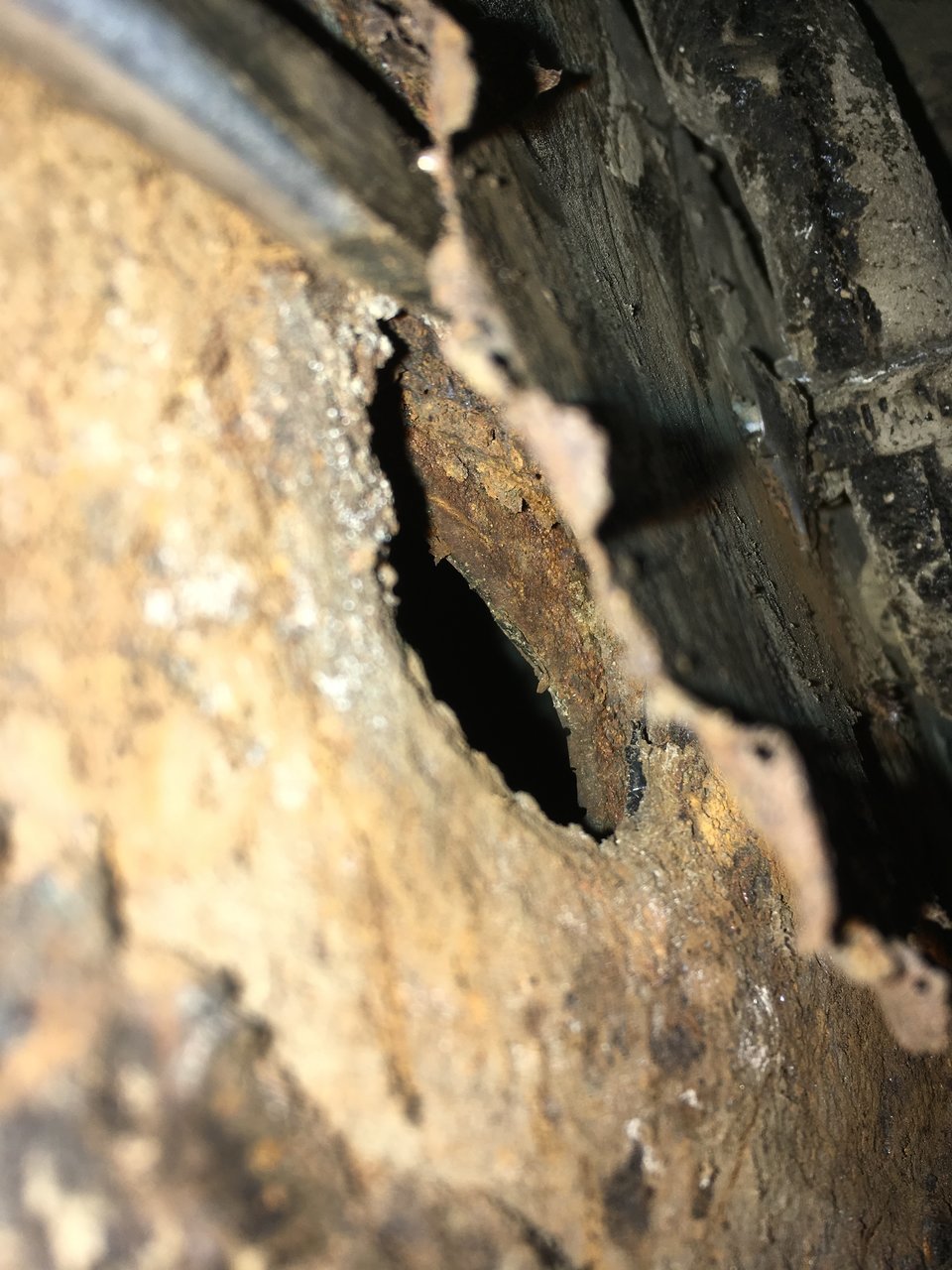

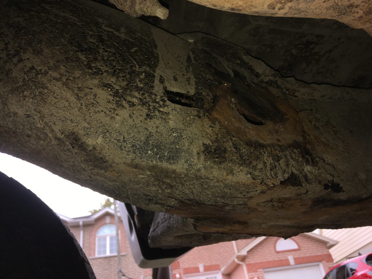

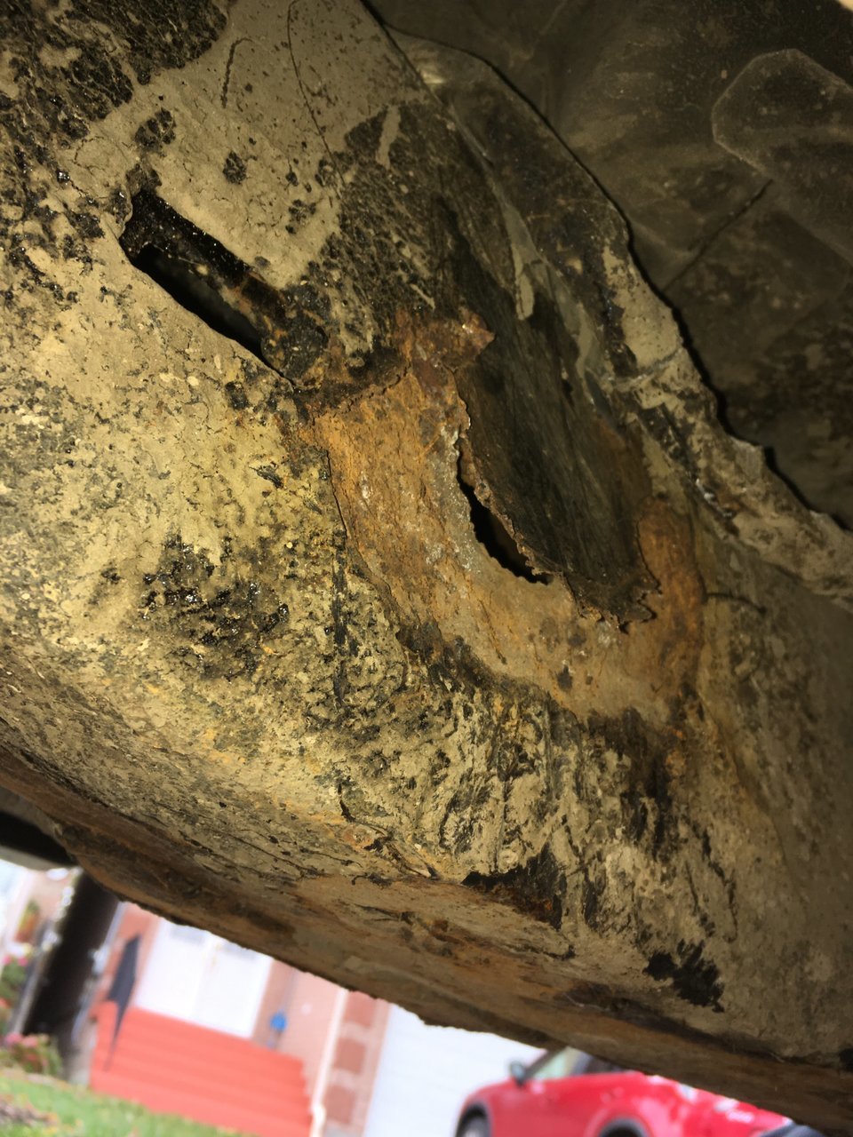

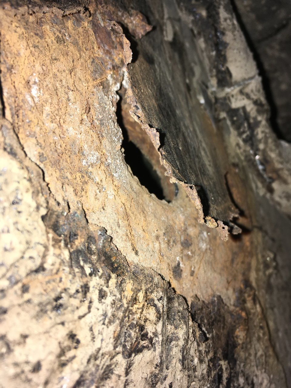

  16. Nov 4, 2017 at 9:53 AM
    #436
    NeonHeights
    NeonHeights Well-Known Member
    Feb 21, 2017
    #211262
    455
    So I was scraping off old undercoating today in prep of getting the truck rust proofed next week for winter. Came across this... Its right on the opposite side of the cab mount on the passenger side by the front wheel. Is there supposed to be a circular hole there that im not aware of? Had a frame inspection this spring and was told everything was okay. But the hole was hiding under the undercoating and you wouldnt of been able to see it unless you scraped it off.

  17. Nov 4, 2017 at 1:15 PM
    #437
    Northern Taco
    Northern Taco Well-Known Member
    Oct 8, 2015
    #166156
    2,816
    2022 Tacoma trd off road premium 2023 tundra trd off road
    That's a common spot to rot, it's close to the catalytic converters which the heat from expedites the process

  18. Nov 4, 2017 at 1:16 PM
    #438
    NeonHeights
    Feb 21, 2017
    #211262
    455
    Its rotted from the inside out too, you can see the bent metal piece on top is still attached, but underneath it has rotted all the way through the frame

  19. Nov 4, 2017 at 4:15 PM
    #439
    Northern Taco
    Oct 8, 2015
    #166156
    2,816
    Been there, seen that:annoyed:
    Once it lets go it's a lot worse than you think.
    lynyrd3 and 20RustyTaco06[OP] like this.
