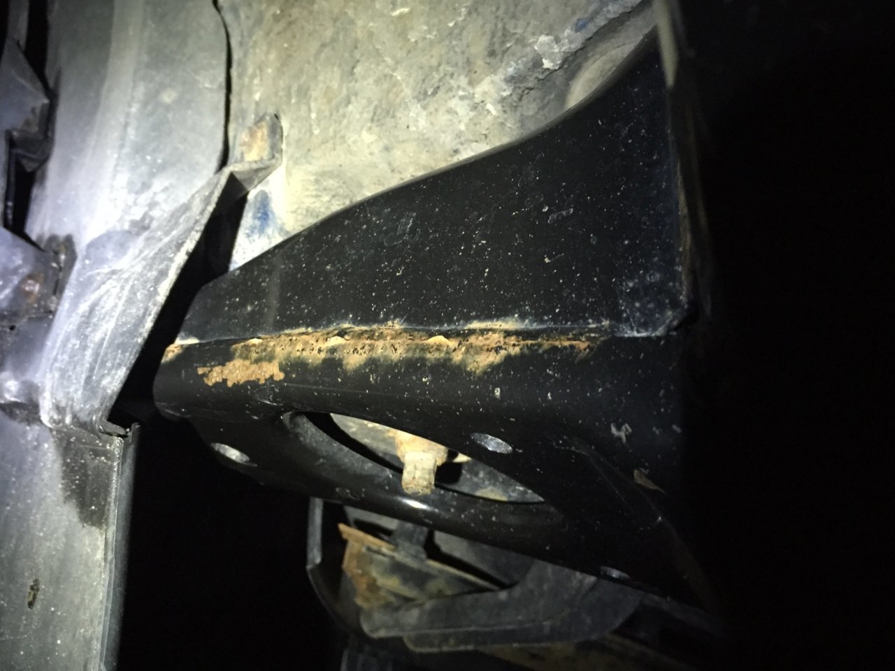

    After a few months of a newly installed frame, I already am seeing some surface rust at some of the shock tower welds. It's not too bad, but it looks like I'll be buying some fluid film and applying once a year. Just a reminder that a new frame doesn't eliminate any new rust, even if you live in California.

    Mines the same way. Believe it or not, Every single Tacoma on my Loacal Dealers lot has that same 'Fisheye' that is only over the welded portions of the frame. If you crawl under the truck and look around you'll notice it targets ONLY the welds. This tells me that the Manufacturer, (Metalsa), has either dipped the frames in the coating tank before sufficient cooling of welds, not properly cleaned welds prior to rustproofing, or BOTH.
    I feel in another few years we'll be seeing this rust issue rear it's ugly head, Again.
    Clean it, Coat it, Maintain it, Religously...

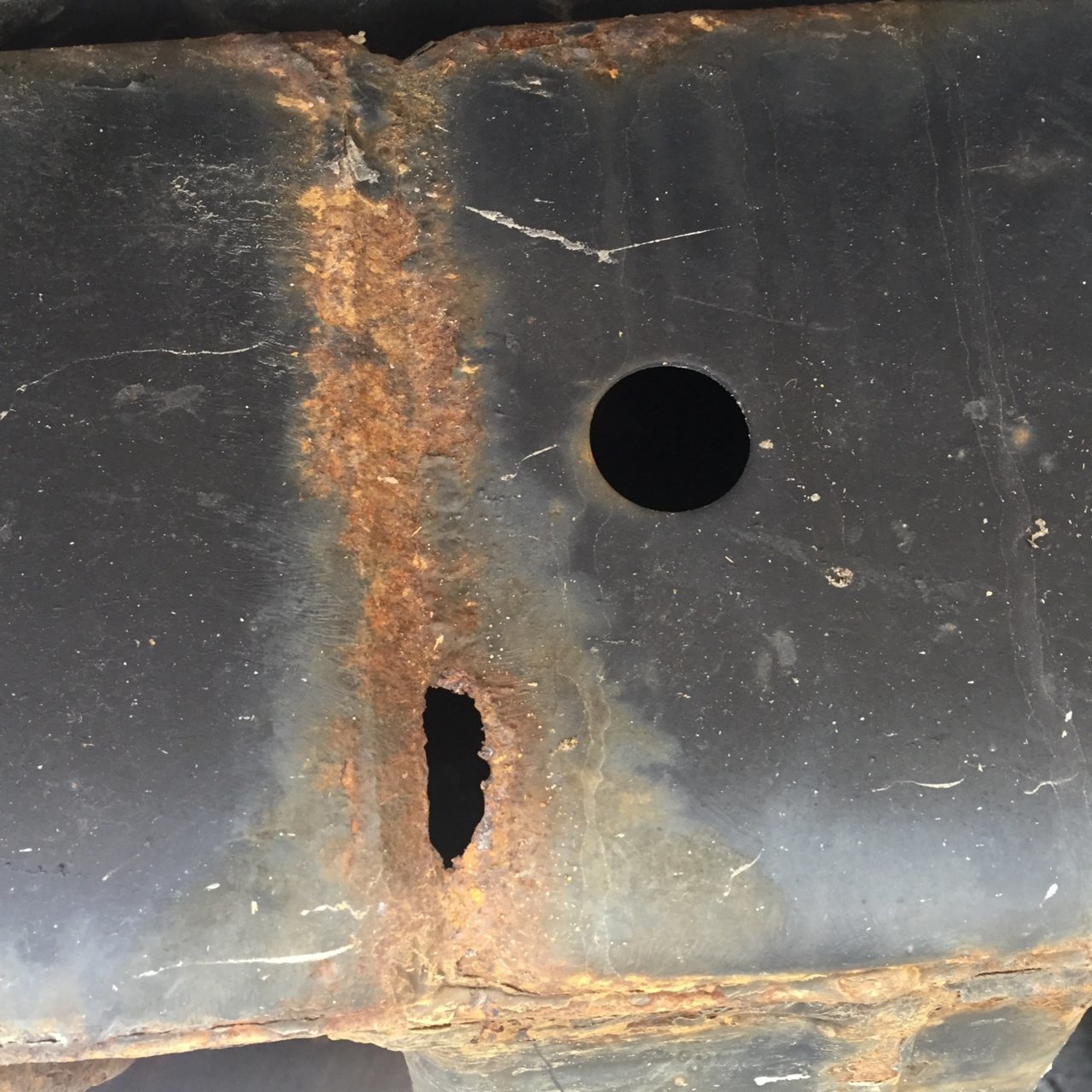

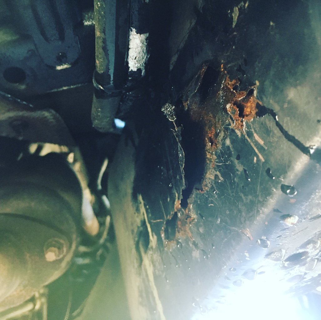

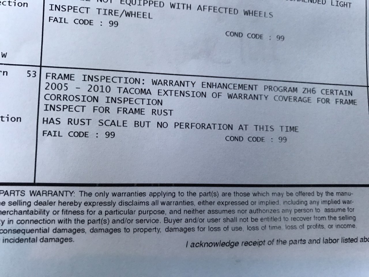

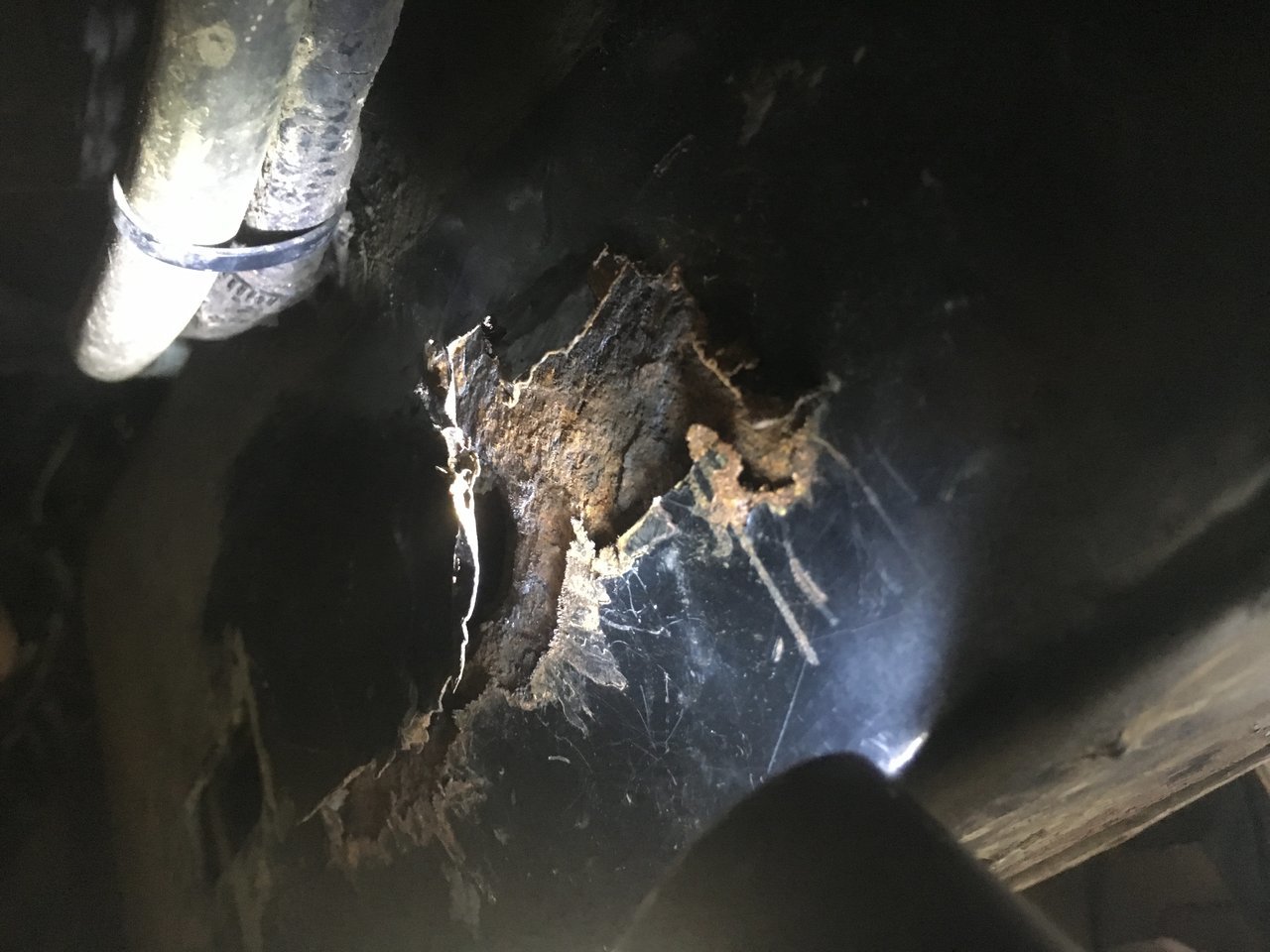

    New frame on the way !!!
    2DDCD604-07A8-43CA-B45F-6BF459B343E1.jpg 54EFB1DA-AFFD-4E2E-A294-BA9E334C2B92.jpg 64DB64C4-D68C-4980-BBFB-878034F7B544.jpg

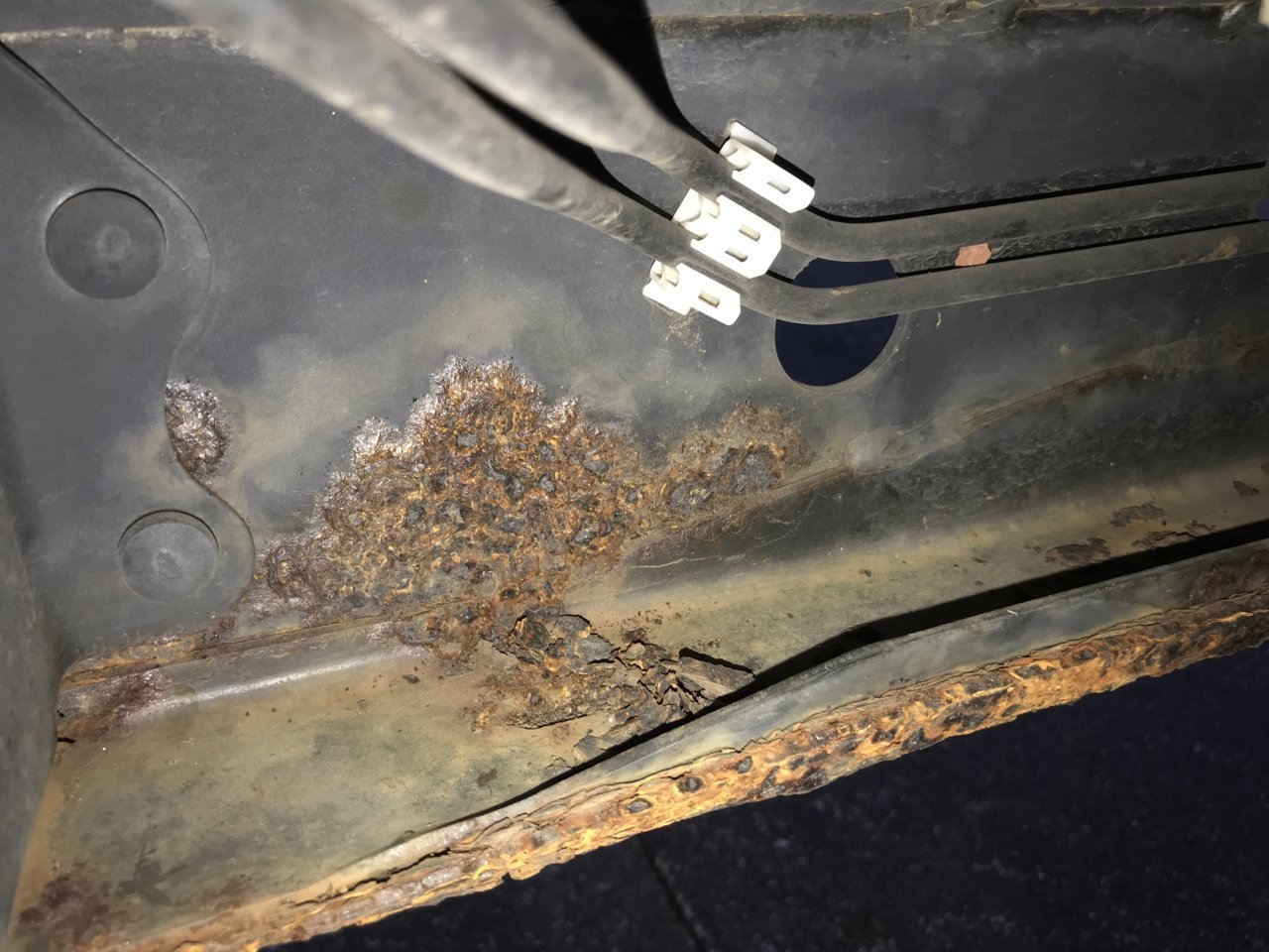

    Are you sure you want one. This is my new one after 1 year

    WTF
  10. Apr 20, 2018 at 12:29 PM
    #450
    roadking1
    roadking1 Well-Known Member
    Sep 28, 2010
    #43941
    910
    n.j.
    2023 Solar Octane TrdPro 6-speed manual
    Where do you live??? Heavy salt use?

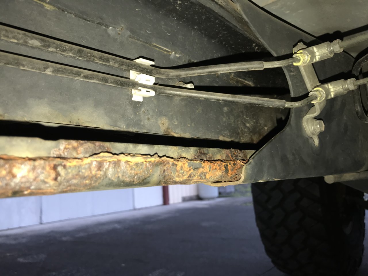

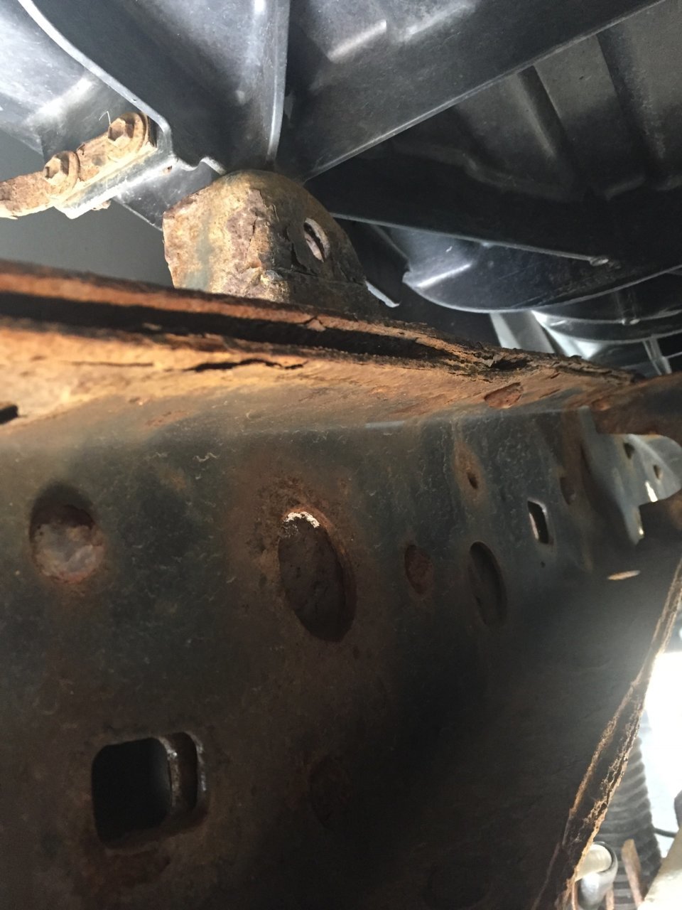

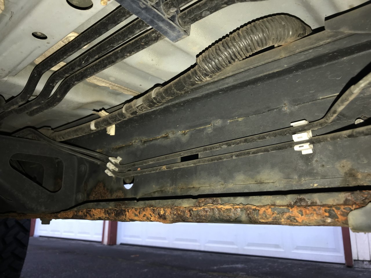

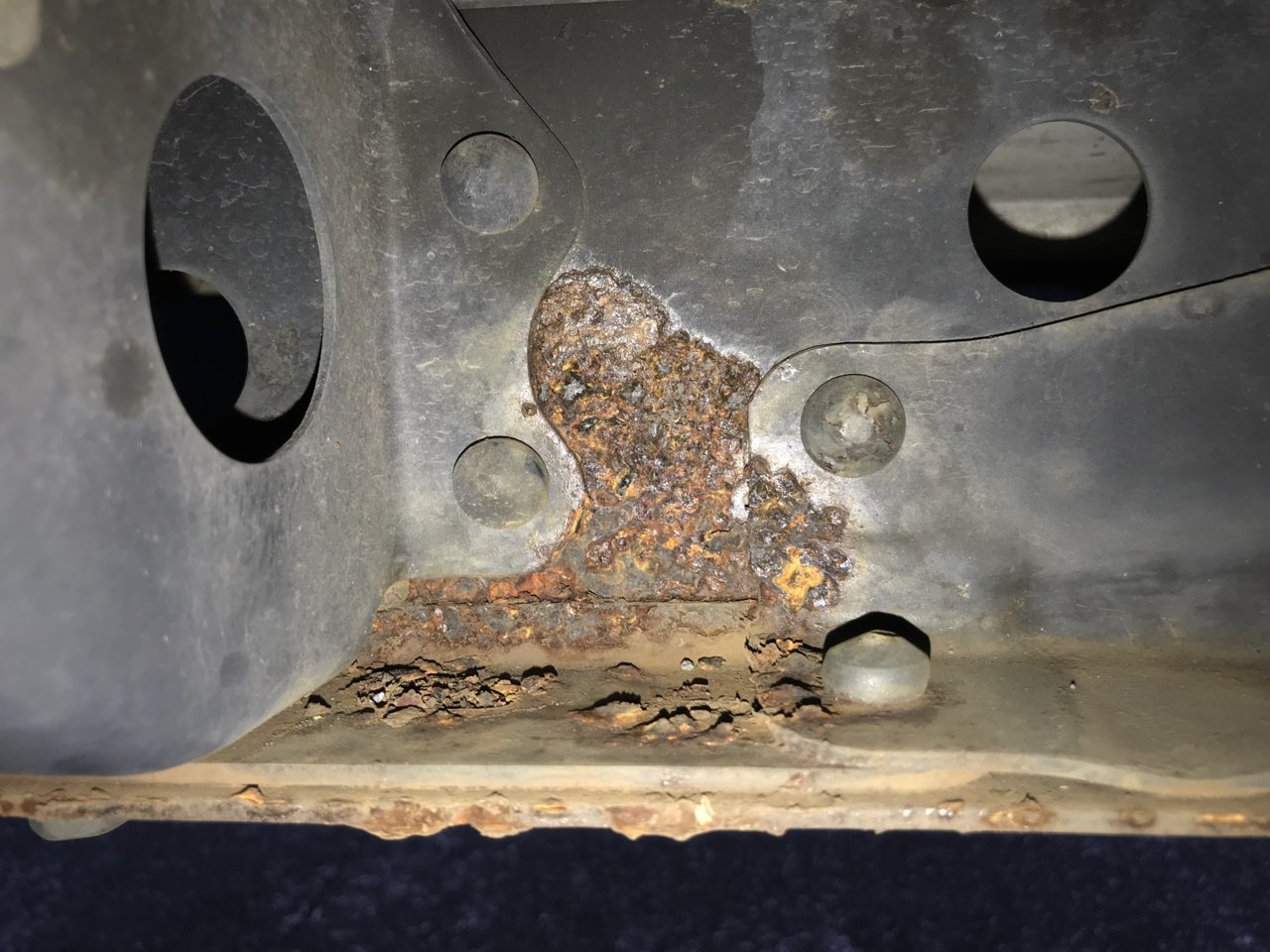

    Went in yesterday and this is what I got...WEAK :facepalm:

    Damn. You guys must live in some salty places. Not sure if it's been mentioned yet in this thread, but Fluid Film spray is amazing for rust prevention and for inhibiting further rust (i.e. you can spray it on already rusted areas). I recently sprayed my frame and it's been awesome. It does smell kind of weird, and if you get any on the exhaust it will smoke a bit for a few days. Small price to pay for rust prevention. It's not permanent because it's a lanolin-based oil, but it's easy to apply and you don't have to worry about covering anything before spraying (except maybe your brakes). I got a few cans at Lowes.
