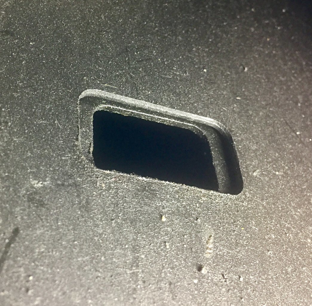

    james
    Rusty Tacoma
    Extra Frame Rust
    Shit man that hole is bigger than 10MM, congratulations you qualify for a new frame!!!!
