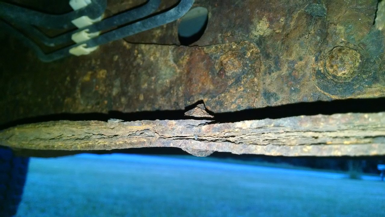

    That's how it starts...
    That open edge is going to swell up 3 times the size it is now within a year's time.
    lynyrd3 likes this.

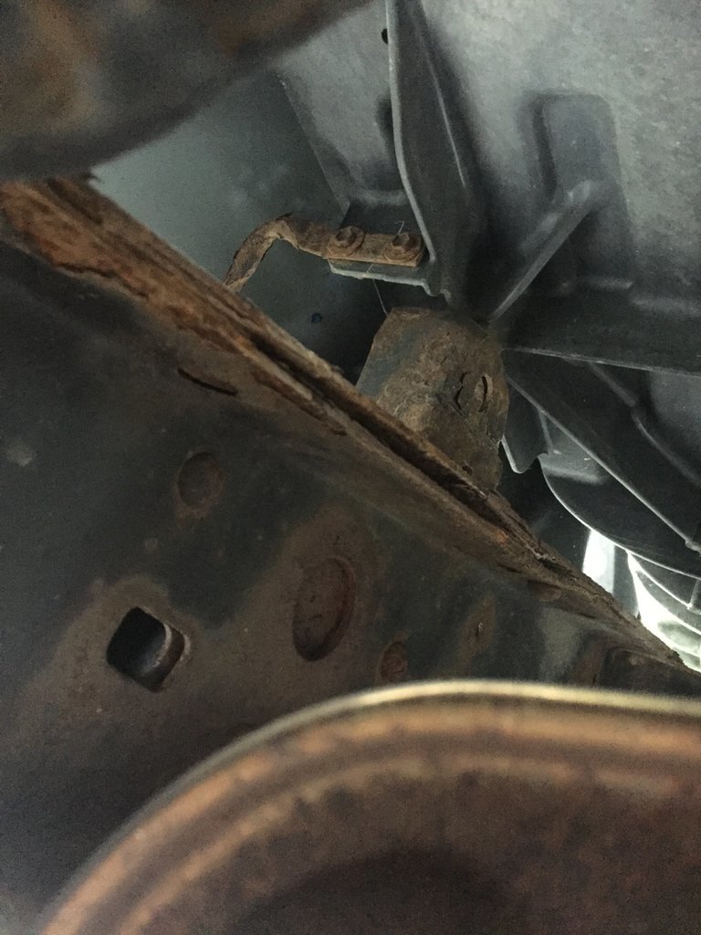

    Like that
    Edit: maybe not THAT bad.

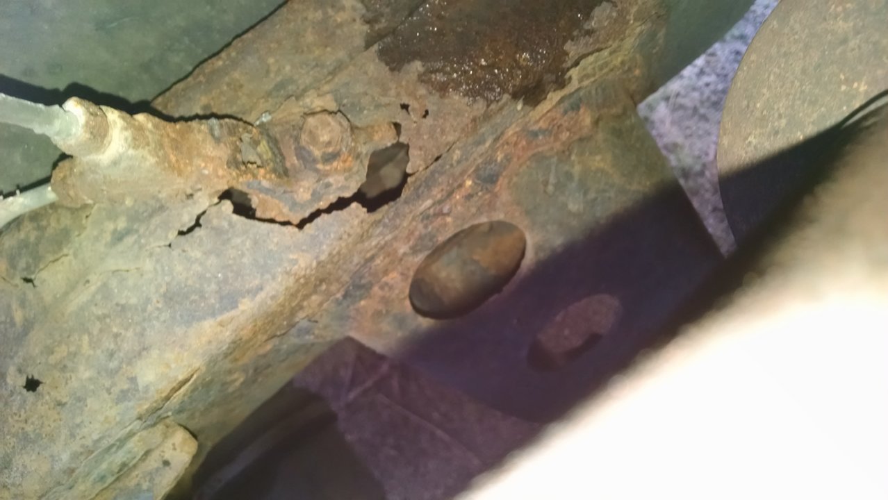

    I changed my plugs over the weekend and found another hole. This one's on top of the frame rail, driver's side, above the axle.

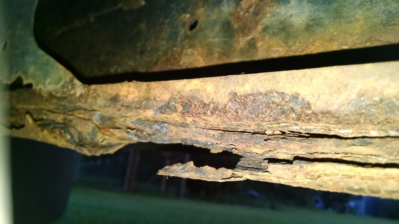

    Before I found out about the frame replacement deal last year I had contemplated finding a wrecked southern taco and swapping frames myself but as far as patching goes, I just don't think I would have anything to work with. What looks okay on the outside is ten times worse on the inside of the frame tubes.
    Wherever they riveted and spot welded two sheets of steel together is major cancer.
    I'm guessing the moisture and salt creep in, and being confined where it is, is impossible to thoroughly clean.
