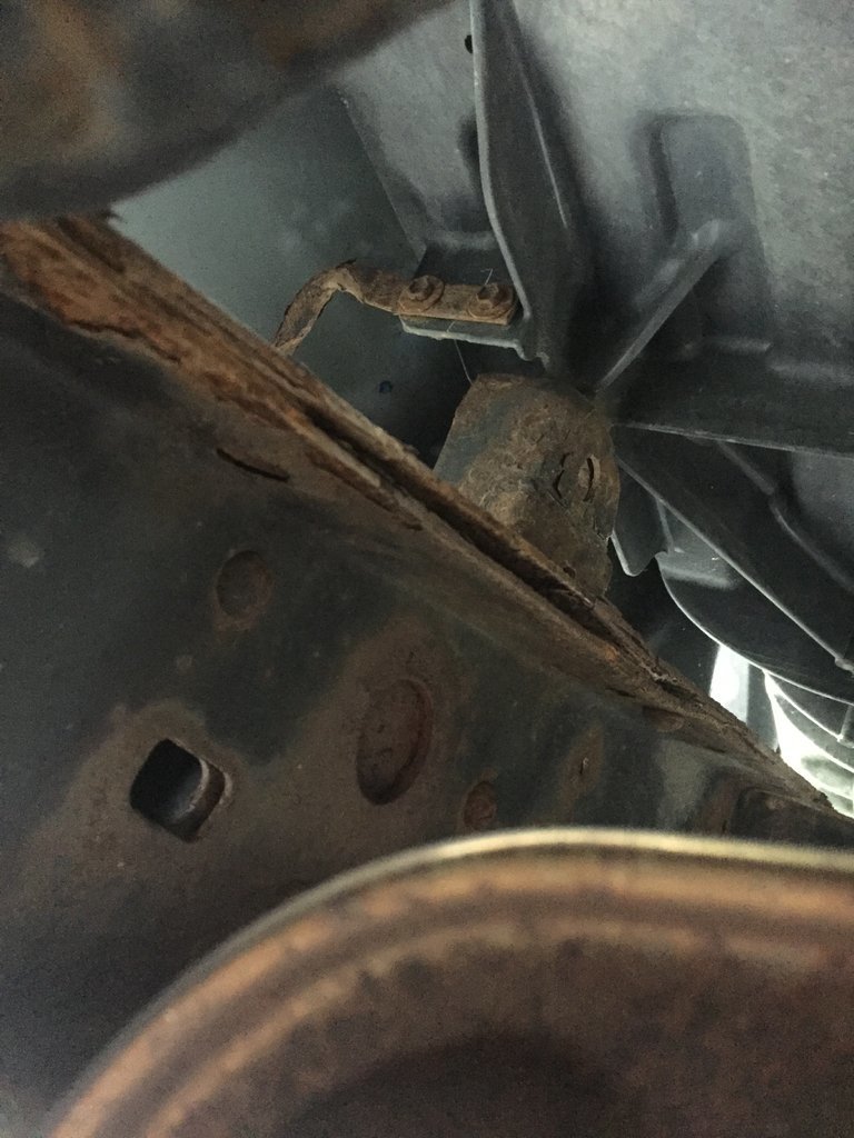

    Well I poked around with a hammer on the frame today , no holes that I can find . Lots of flaking and scaling in some areas . Inside the frame near the cats is full of scale but no holes I can see . :mad:

    Went to work on the frame with a hammer today and can not find any holes . Just scaling and flaking. Some seperation of layers .

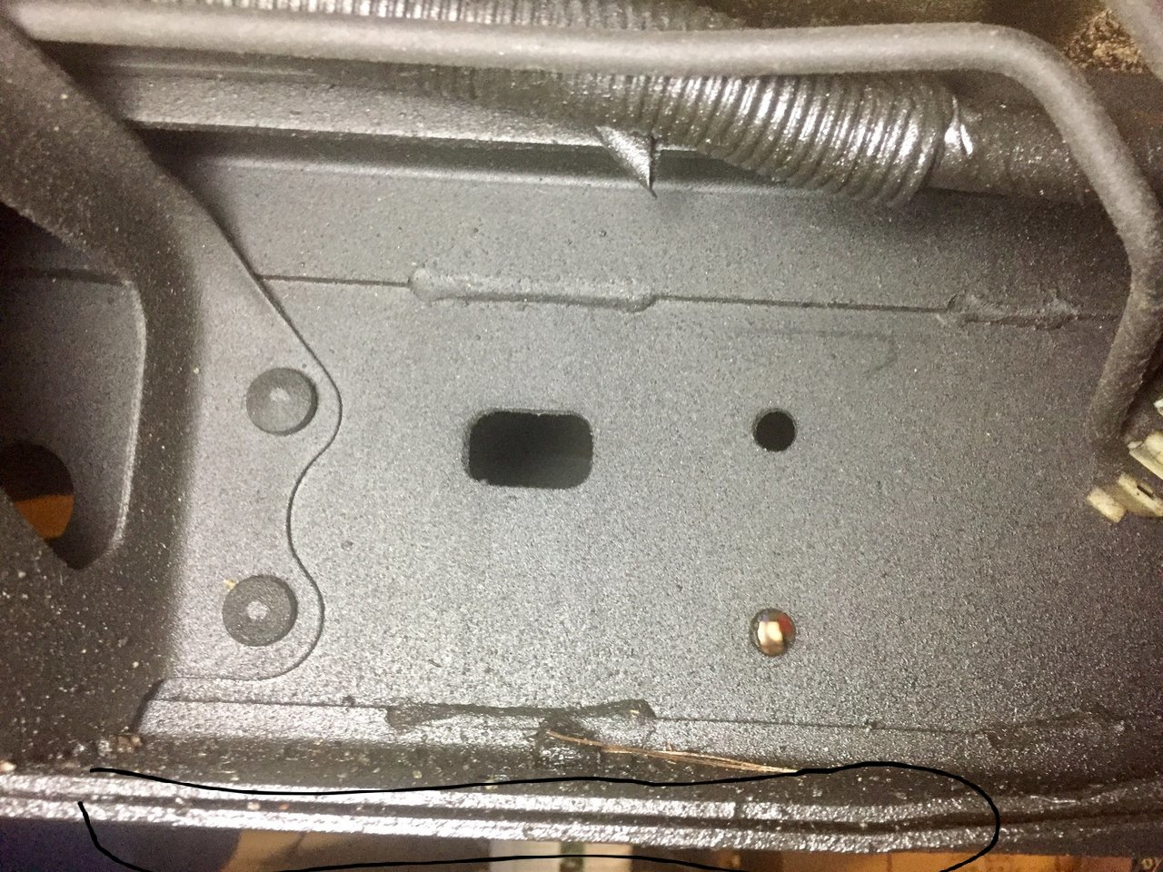

    No rust but look at the second picture real good, Give it some time. I have an 05 Durango. It has surface rust but it has no holes or layers of metal coming apart. It has been through the same salty snow roads as the Tacoma.

    Wow, seeing what the bottom of the frame rail looks like new, I can see why I have such an issue.

    That welded reinforcement tab just sandwiches salt and road grime in there to fester.

    I see a pine needle in the second pic, some in the fifth photo too--am I missing something?

    20170801_201911.jpg correct me if I'm wrong but I don't think that should be happening to a frame.

    My point is that it should not happen to a frame that has had "proper maintenance". If I am wrong then I apologize.

    That's not lamellar corrosion, just the manner in which the frame is constructed. When rust does get in there it "fishmouths" as shown in this photo:
    Armkb's proactive preventative maintenance has saved him a lot of hassle. I'll get a photo of a similar area of my "Florida" truck's chassis in the morning...

    Yea , that's my frame ! I cleaned and sprayed with Rustoleum rust reformer every year and this is what I got :(
