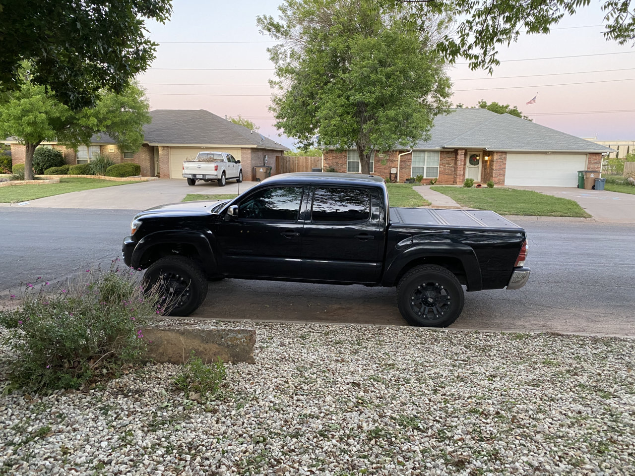

    I just upgraded my suspension and I'm not real thrilled about the stance. I've got Bilstein 5100s all around with Eibach springs and freedom off-road upper control arms up front.
    I'm thinking about doing an AAL in the back to level the truck back out. My question is, which one is best for ride quality and lift?
