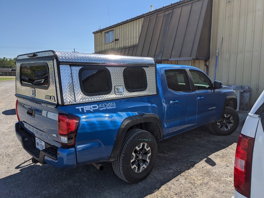

    So now that I've got my decked system + aluminum cap on the bed of the truck it's definitely a bit lower. I test loaded some stuff for camping including my bike rack and bike and the rear of the truck sagged another ~.75". I'll probably lift the truck eventually, but I'm not going to do it now and I'd like to help out with some of the sagging. The Decked + cap is probably 300 - 350lbs of weight that are always on the rear axle. Truck is a 2018 TRD OR.
    I'm looking at the deaver AAL (TACOAAL). I'm planning on changing nothing else about the suspension. Is that the best option or should I get another brand?
    Pic of truck for attention:

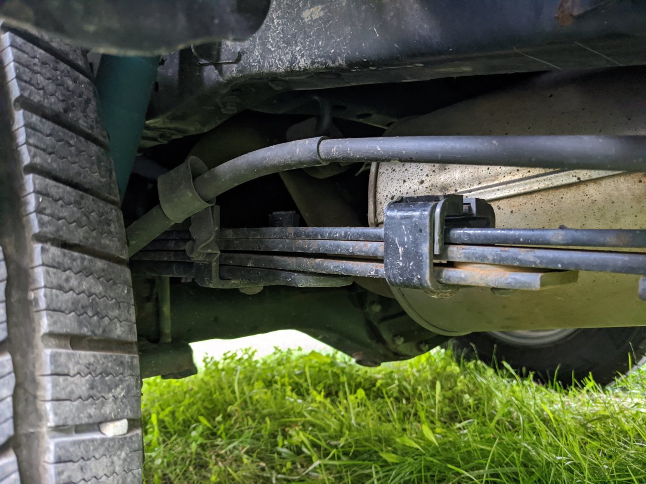

    Are they doing a re arc of the springs? Also can you take a picture of the OL touching

    It's making more contact in the front.
