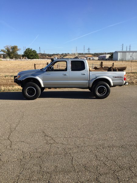

    I have the 1.5" ToyTec AAL w/ the overload left in & Icon 2.0 smooth body shocks. It sits level w/ the 3" lift up front empty. Rides just fine, even with a bed full of firewood. Although having a D.C. My bed is shorter than a normal size bed. It does sag in the back w/ the bed full. But has never hit the bumpstops. We all know AAL's are just a band aid compared to replacing the whole leaf pack. I also have 252k on the original leaf pack. So it is about time to replace. I don't haul much that often though. So that's why I haven't spent the extra coin for new leaf packs. Here's a picture of it w/ Red fir & Cedar in the back.
