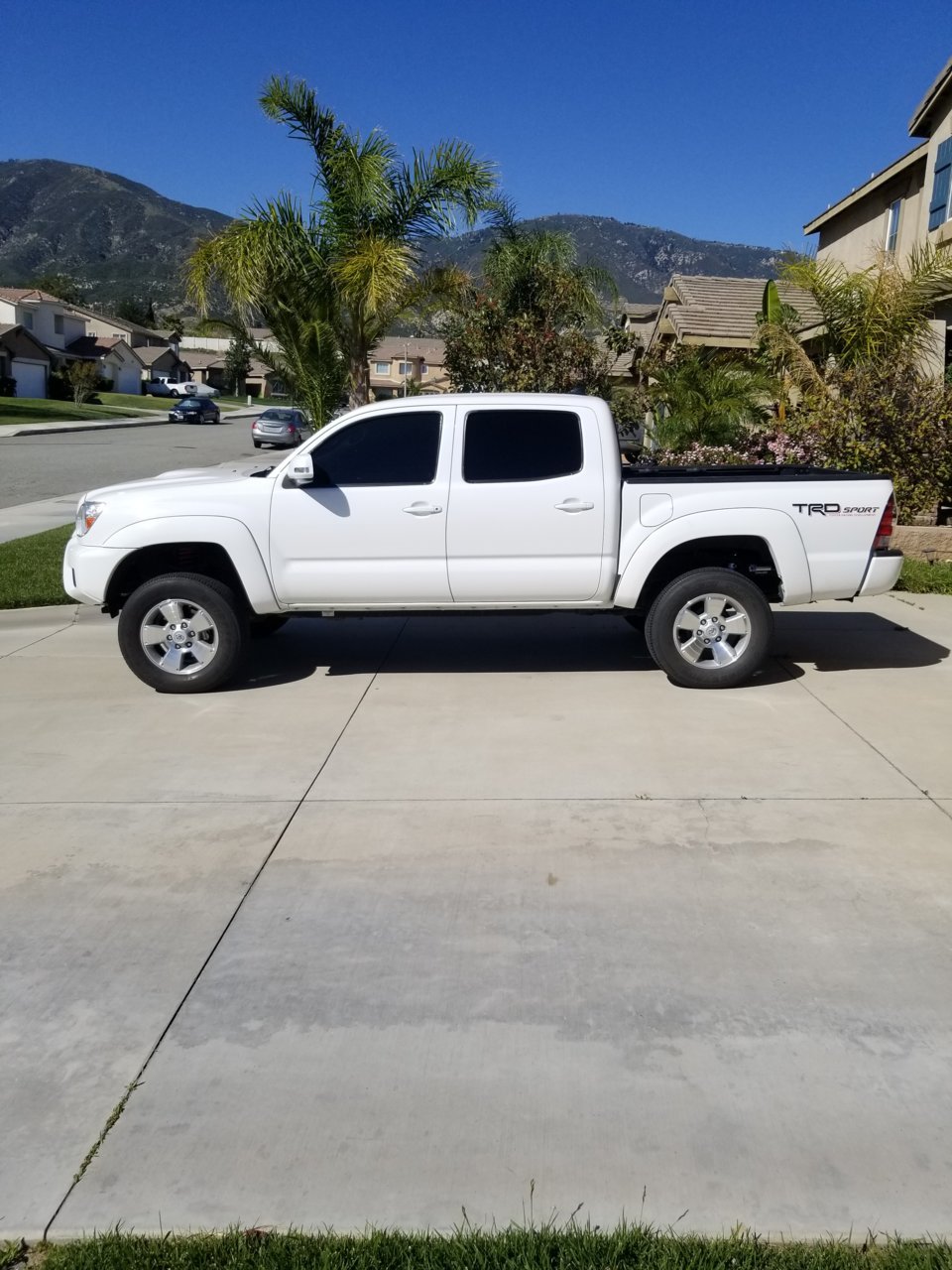

    No experience with them, but Alcan can make custom leaf packs to your desired height and strength.

    If you want a cheap option I got a trail gear single AAL for under $100 canadian taxes in and installed it myself.
    I think it rides great. The 3 leaf system gets most of the lift from the thickness of the AAL pack and the single AAL adds lift from the spring tension. The 3 leaf won't increase your load capacity much.
