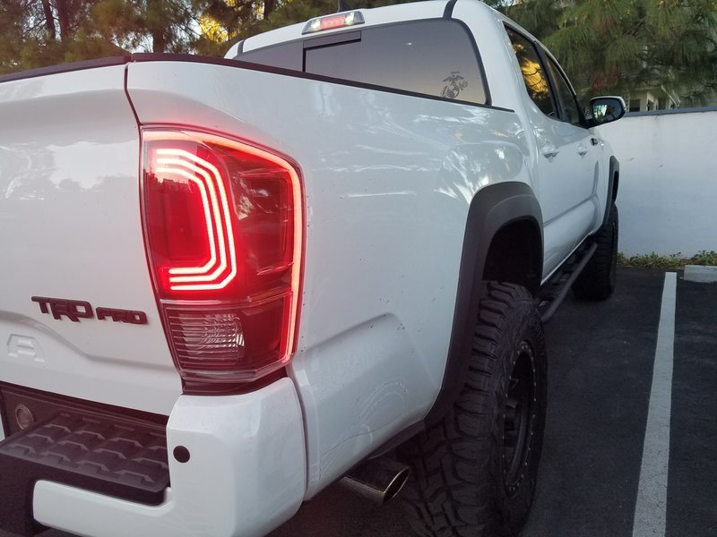

    TRD Pro tails :thumbsup:

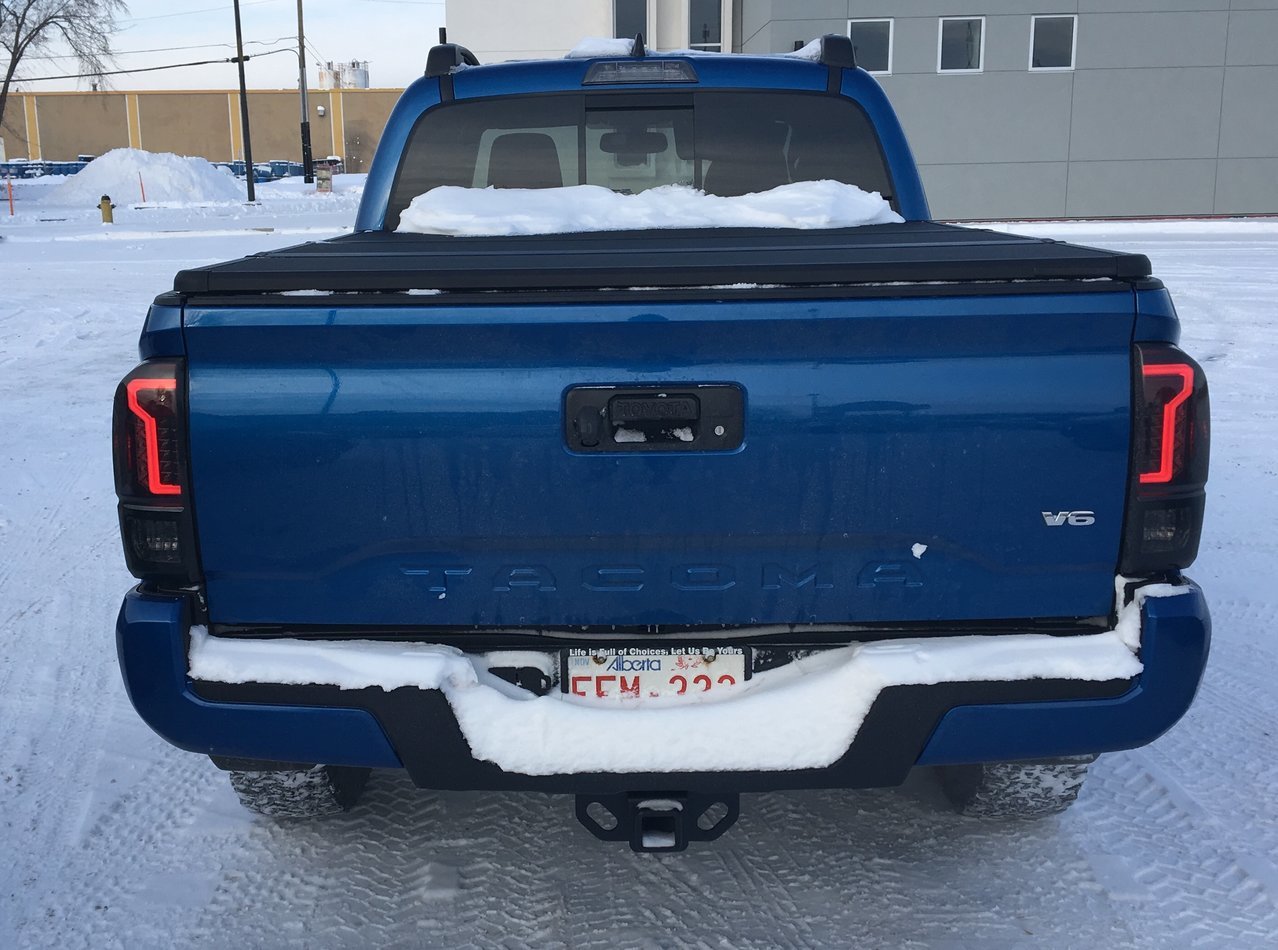

    So, I somehow blew a fuse when I installed, then yesterday when I checked the fuse that I thought was good, I must’ve checked the wrong fricken fuse, guess I had my Saturday brain on! New fuse=happy. Thanks for stickin with me!E051FD71-E1AE-4066-A9BE-69A71FCDA3F7.jpg

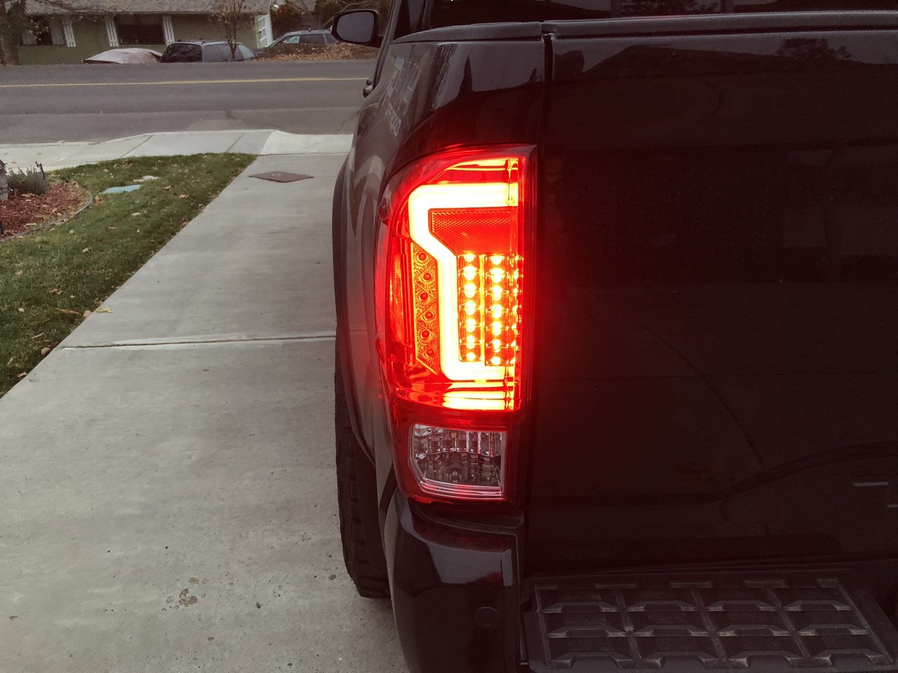

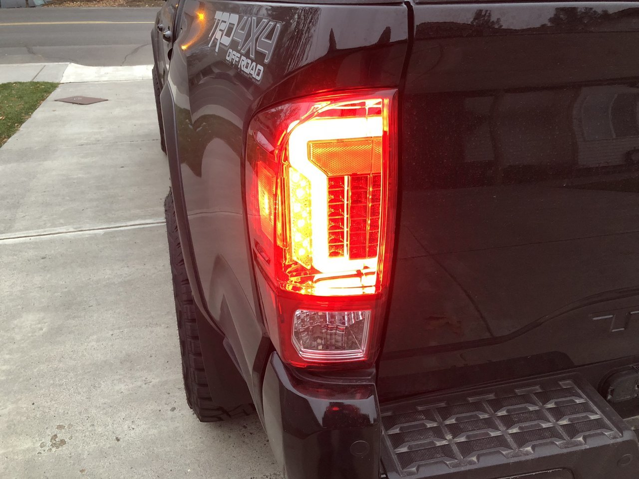

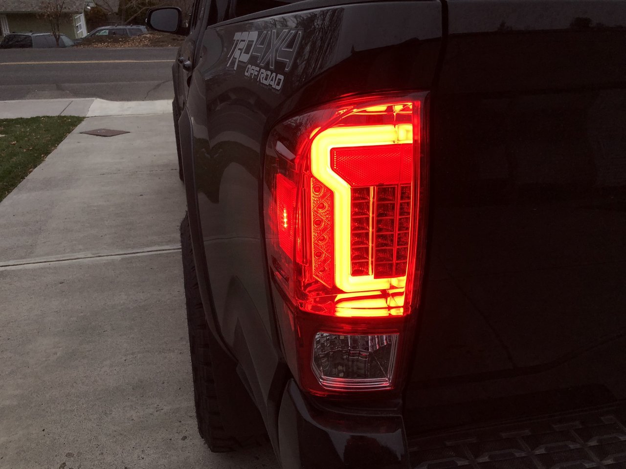

    Here is my review on the winjet
    Installed my tail lights last night and all done and so far I'm pretty happy with them, however I did run into some snags.
    First of all the fitment and install of the housing went easily and they fit perfect, and if you follow the directions step by step from the video you will not have any of the blown fuse or other issues.
    Video is here: https://www.tacomaworld.com/threads...il-lights-comments-concerns-questions.527744/
    Snag #1 was that on the passenger side housing, the section for the reverse light wasn't cut out correctly so the socket for the reverse wouldn't go into the housing at all. I had to enlarge one of the slots a little and once I did that I could get the socket into the housing.
    Snag #2 was that on the driver side, for some reason when I turned on the blinker it would blink super fast like it normally would on led bulbs. After messing with with the housing a little, I noticed that the black wire that is connected to the small white clip next to the fan was loose and eventually came unplugged. After resetting that everything worked good and still is this morning.
    Outside of those minor snags, everything else went great. As for my review - I would say the only thing for me is that the blinker isn't too bright, but others have also mentioned that already. Brake lights seem to be bright enough and the parking light portion is super bright. So far I like them better than the oem housings.
