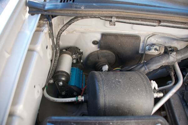

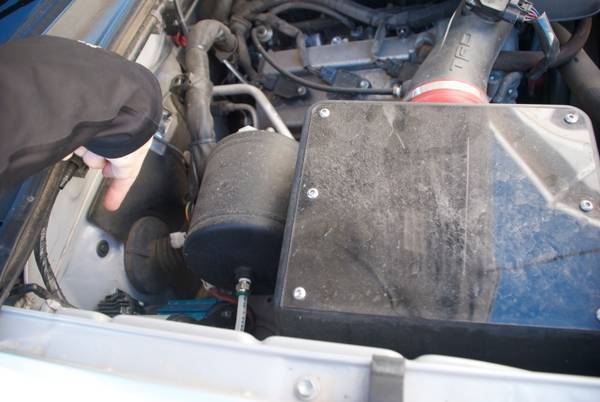

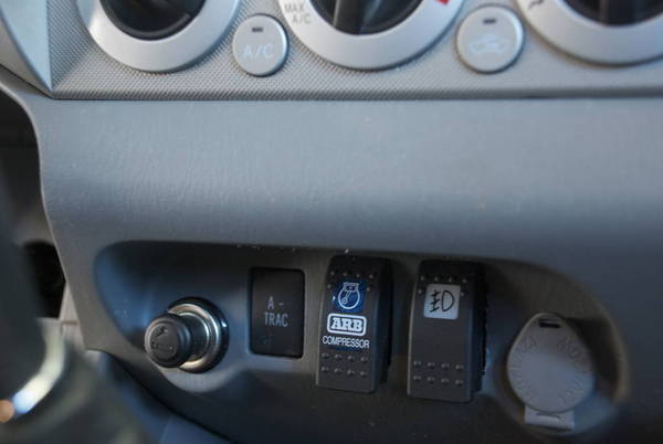

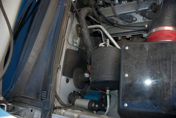

    A couple of things. My compressor usually only comes on for a few seconds to fill the Mini tank it came with. Its rated for both front and rear lockers + airing up tires. I think compared to the viar its way way quieter, but thats my opinion. A couple of things on installing, I had a buddy do the same install but he put the compressor on a black rubber gasket base that way it reduced vibration, this made the sound about 10% lower than mine from inside the cab. Also I wish I had of mounted the tank in a different location to free up the area for my dual batt system. My buddy put his under his rear passenger seat in the access cab next to the stock jack (still there).
    Switch panel
    The mini tank is black, lol just so people see it.
    A better view and to see the kind of room we are talking.
    This is the place I should have mounted the compressor. I will re-do this in the future.

    Thanks for the pix.
    Not sure I'd have the guts to drill mounting holes in the firewall there, with no way to see for sure what's on the other side that's going to be hit by the drill & sheet metal mounting screws.

    When I pulled the dash apart to do my ipod install, I found that on the other side is an additional spot to run wires in to the truck. It has tons of space and would be totally clear. Plus the issue I have found is that in that location It takes up too much room how its mounted and under neath you have water and stuff touching. I like that against the other spot its water proof. Also moving that mini tank makes a huge huge diff. It will free enough room to have my second bat set up and not have to loose my CAI. Plus I am a huge stickler for proper weight distribution. Between the hi-lift in the rear, and the dual bats moved, + myself and my girl the truck is only off by 11 lbs on the passenger side. Thats totally anal but I like things to be done right.
