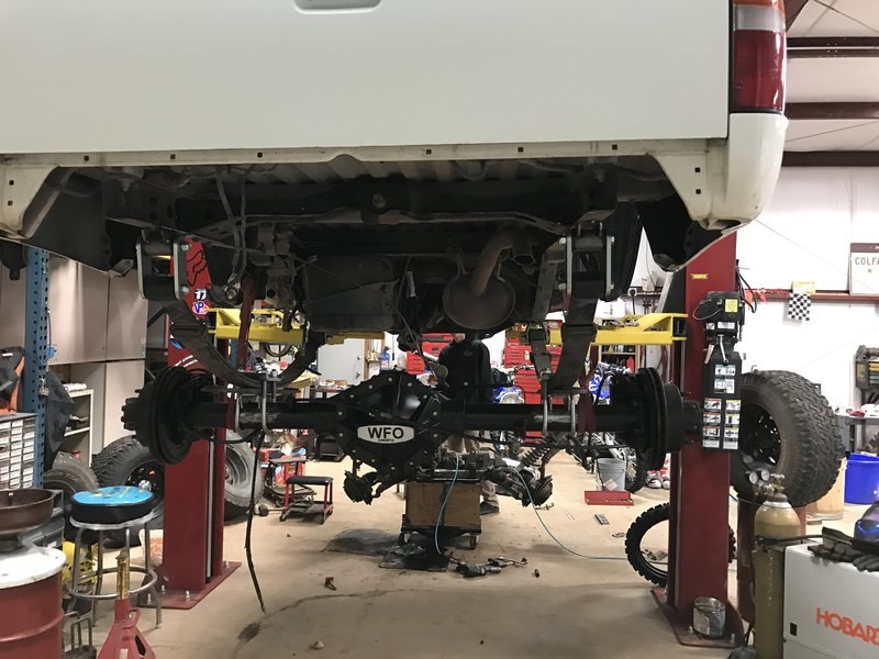

    Also. Are you doing the gearing/building of the 1tons yourself? Cheapest my buddy got his axles ( Kingpin d60 and 14 bolt rear) Geared, ARB air locked both front and rear, and bullet proof case covers on both, was 5700, with a buddy discount. But they are bad ass.. Only have a pic of the rear right now, going to finish up the swap on Saturday. His build costed about 11k, 14in king coils and 14in king remote res in the rear on 40s.. Bad ass build. IMG_7477.jpg

    Jeez, that's extremely cheap for those axles! Is that for a basic build, or did that include all the bling?
    I got around 5 grand on my front D60 alone LOL. Actually, the basic build with gears and air locker was about 3 grand rebuilt hub to hub - that included the price of axle of course. BUT then I went with chromo shafts, upgraded u-joints, aftermarket knuckles, upgraded steering arms with double shear set up, Yukon hard core hubs, etc. So that was another 2 grand on upgrades.
    And damn, 11K for an entire build, as in a complete turn-key build? Was that with links, hydro assist, steering, wheels/tires, brake upgrades, transfer case, and all the other stuff? If yes to these questions, damn, that's extremely cheap :D
