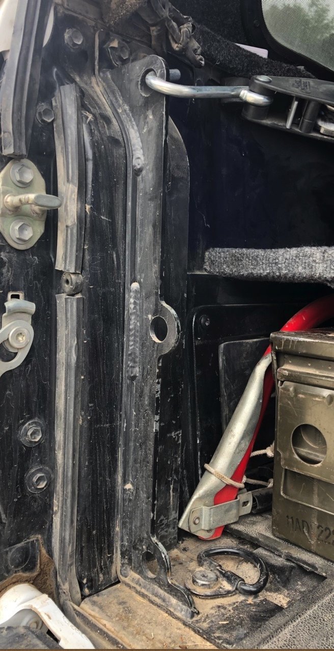

    I got the type that follow the curve up to the plastic cap. Don't know how much better it is but I figured it might help. When I got mine there were 2 manufacturers of them and they argued over design/copy issues. My guy lost or bowed out so my brand isn't made anymore.
    I will say since mine are taller the cargo tie off point is higher and I do use it the most.

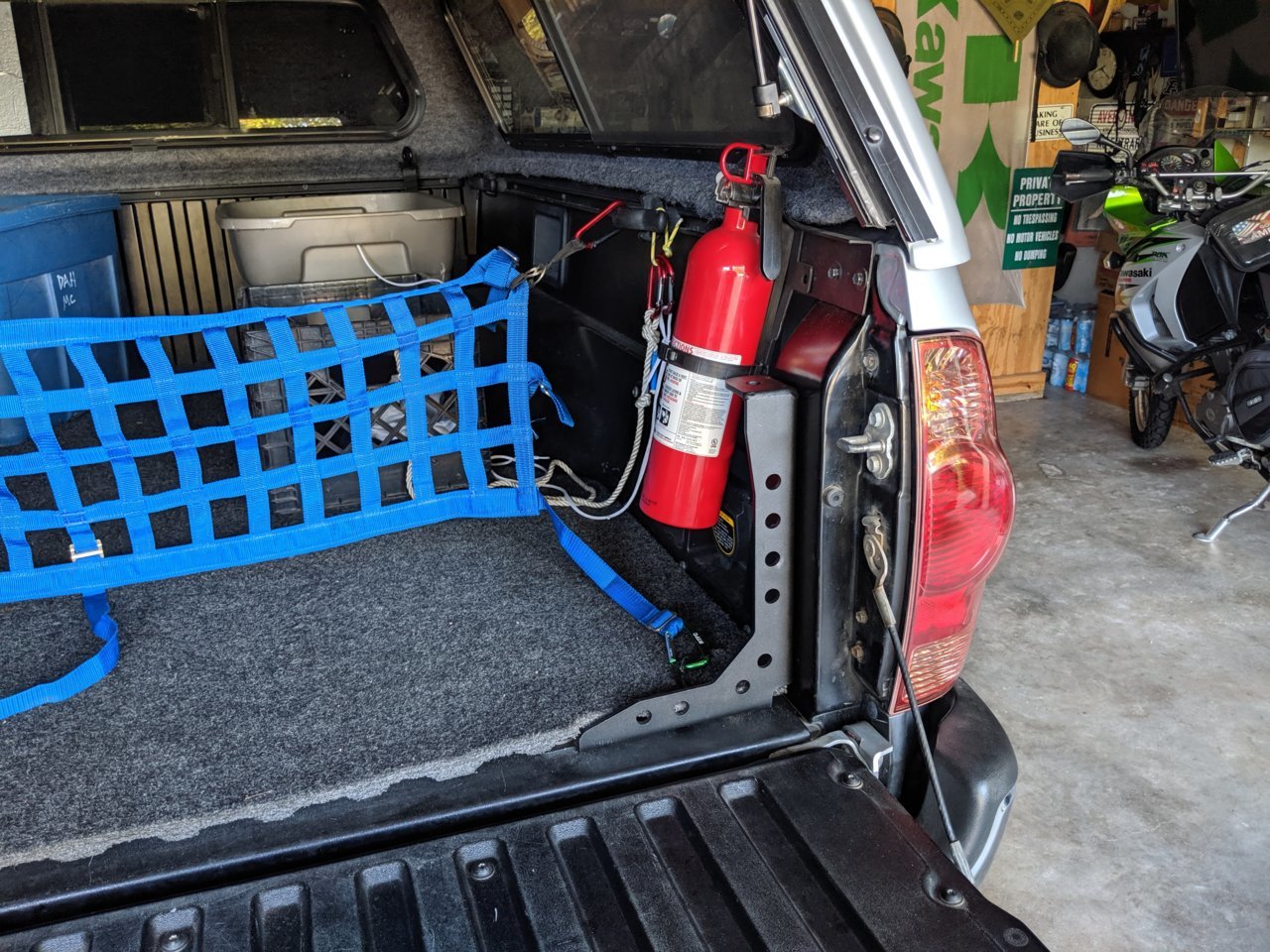

    I have a cap on my truck and I went with Caliraised. Very happy with them.
    Whichever bed stiffener you choose, I would strongly suggest (as mentioned in other threads on same subject) to use a ratchet strap to sinch in the sides of the bed while doing the install. This will help to bring the sides of the bed to a more normal position.
