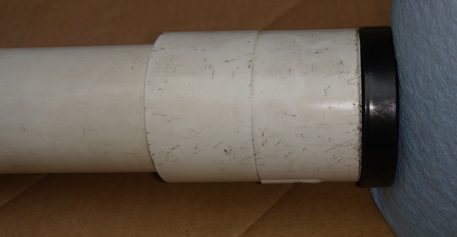

    Here's another member that uses PVC with a coupling for installing seals. I just take the seal to Lowe's and find some PVC with the exact fit.
