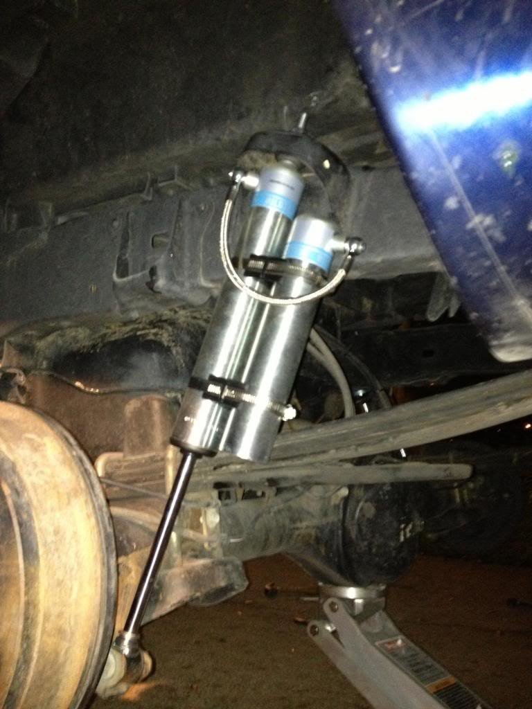

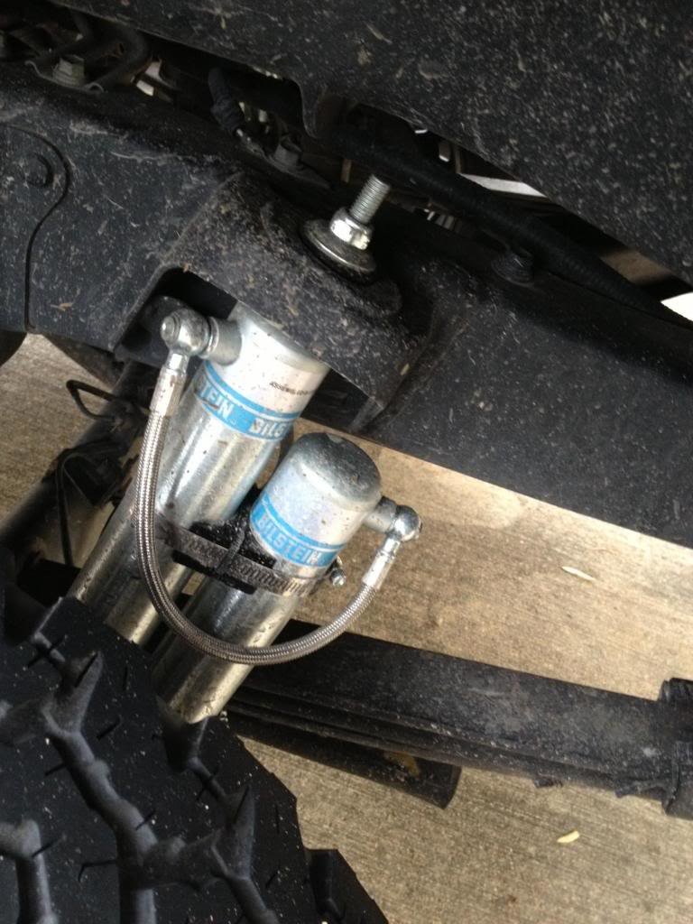

  9. Feb 28, 2013 at 9:06 AM
    aubi1414
    aubi1414 War Eagle!!
    Nov 15, 2011
    #67072
    2,303
    Justin
    Pensacola, FL
    2014 Tacoma TRD Sport Blue Ribbon Metallic
    LED Dome, LED Map, LED License Plate Bulbs, , Konig SixShooters Matte Black, Toyo Open Country ATII's 285 70 17, Satoshi, Bilstein 5100s (set to 0), 885s, LR UCA's, Icon RR 2.0 +2, All Pro Standard 3" Leaf Pack, All Pro Flip Kit, Sway Bar Relocate, Exhaust Chop, Antenna X 14", Debadged, Tint, Matt123 Black TRD Skid, Black Weathertech Mats
    ^Pics please :D
