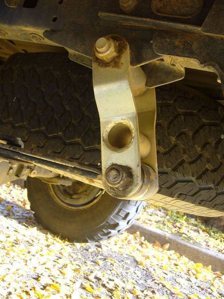

    also, what shackles are you running? if i recall, stock shackles should be 6" eye to eye... your pic looks like stock shackles... maybe just the angle of the pic...
    if the rear was at 3" of lift, your truck would be sitting bull dog as the ratio from front to back is about 1.5:1
    3" in rear typically sits level with a 5" front lift...
    1.5" in rear typically sits level with a 3" front lift...

    i did research and the shackles i have appear to be the daystar 1.25 and thats plus the 5-pack alcan springs from wheelers for 1.5 of lift.
