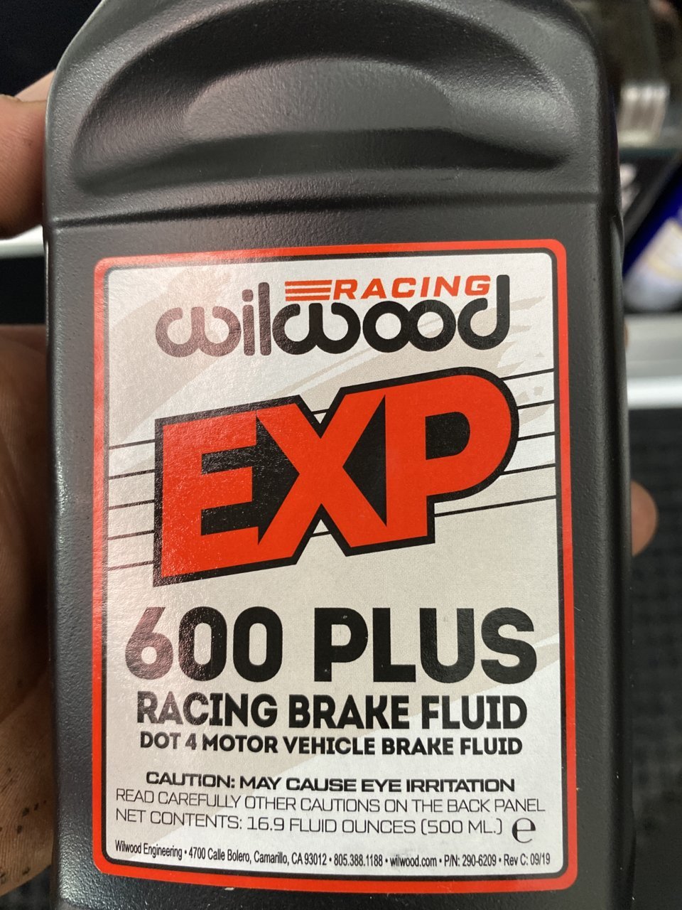

    41BE12EB-54AF-417E-B6DB-937CB015BB00.jpg What do you guys think about this fluid

    I think it's probably expensive when you can get this at Walmart.

    I've seen that for years, but refuse to put any Dot3 or Dot 4 brake fluid into my trucks that has "synthetic" on the label.

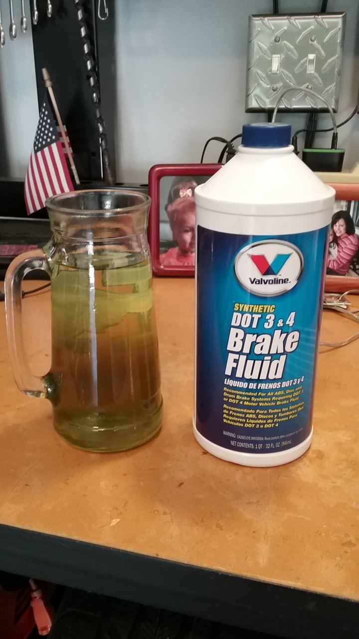

    I use Prestone DOT 3, never had any problems even when towing at 200k miles. It’s synthetic, just like all decent brake fluids are.
    Old brake fluid usually has a darker color to it, you’ll know when it’s all flushed out.

    Aren’t they all synthetic? Even house brands usually say synthetic, and Prestone says synthetic which is one of the biggest and most trusted brands for brake fluid.
