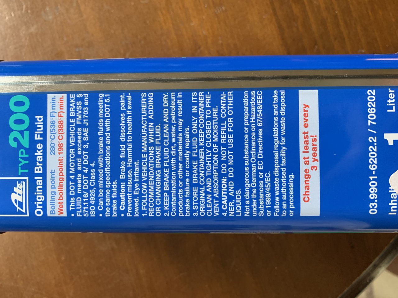

    Feel free to point out where this ATE brake fluid says "synthetic."
    They do sell brake fluid at stores other than Walmart.

    It doesn’t seem to, but it’s also German and a brand of brake fluid I haven’t seen before (should I point out this is a Toyota forum?).
    All of the commonly available brake fluids in America that I’ve seen are advertised as synthetic, including Prestone, Valvoline, Amsoil, Lucas, house brands from Autozone and O’Reilly, etc.
    I haven’t been to Walmart in about 10 years, but I did go there quite a bit when I was broke and putting myself through college in mechanical engineering. There’s nothing wrong with buying name brand stuff from Wally World if you’re on a budget and don’t mind the long lines.
