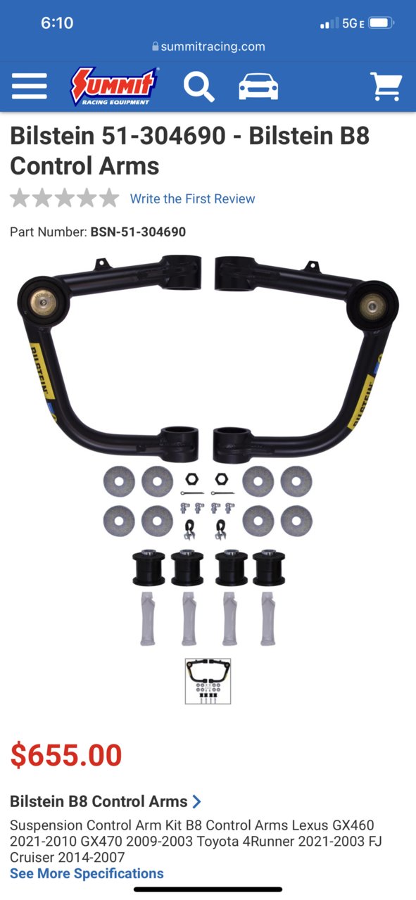

  19. Jan 26, 2022 at 8:32 PM
    #19
    adriancast
    adriancast Well-Known Member
    May 20, 2013
    #104544
    2,310
    Adrian
    Ontario, Ca
    2005 Tacoma 4x4 TRD Off-Road
    -2.5 Donahoe Coilovers -All Pro Standard Leaf Pack -All Pro U Bolt Flip Kit -Front/RearWheeler Super Bumps -Extended rear Bilstein 5100s -Flowmaster 40 Series -All Pro IFS Skid -All Pro Transmission Skid -Bruteforce Hybrid Bumper -30" Double Row LED bar -400 Watt Anytime -TRD Seat Covers -ABS Kill Switch -Locking Center Console Mod -Rear Differential Breather -BHLM -Anytime Fog Light Mod -Toyota Hilux Snorkel
    Just saw these. Bilstein UCAs. Going to go with these on my wifes 4runner. Already have bilstein shocks all around.
