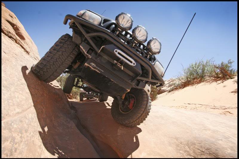

    Just to share a pic from another angle of the TG bumper. Took some abuse recently in Moab with no complaints.
