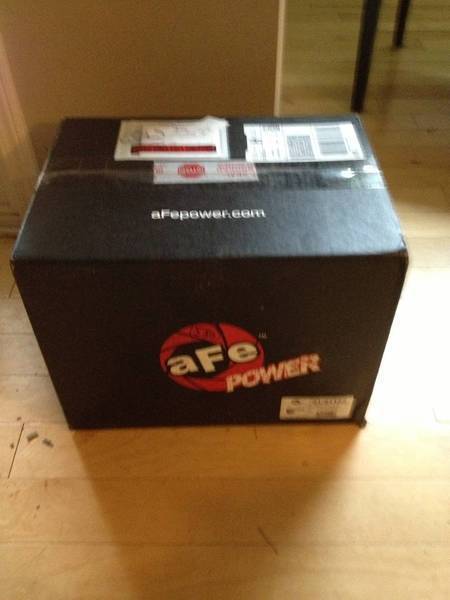

    Sitting on my doorstep this evening. :headbang:

    ^^ AWESOME!!! Same one I would've gone with!

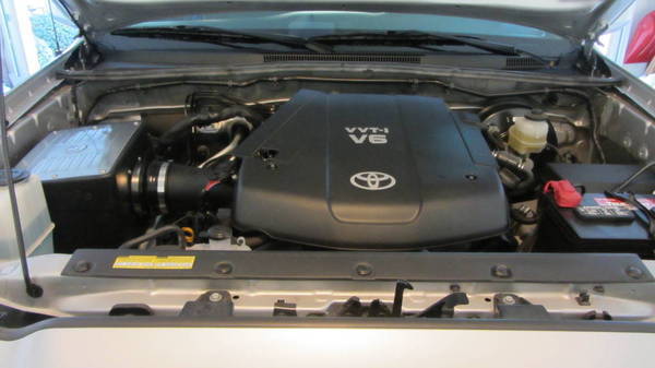

    It's installed!
    Sounds mean at wot. I had read it was loud all the time. Not so far, seems the same until I get on it. But I haven't had much time driving yet.
    After the install my ABS and a VSC light was on. :confused: What the hell does that have to do with disconnecting the battery and maf sensor?
    I did the maintenance reset and it's off for now. They did come back at one point but when I started the truck again they were off. :confused: Is this normal? Maybe it needs time to reset the cpu?

    Looks good. As for the lights, how long did you have the battery disconnected? I just installed a volant myself and when I first started the truck I had forgotten to disconnect the battery. It was idling pretty rough and unevenly, so I left the battery disconnected for 30 minutes. That fixed the rough idle and I haven't gotten any lights of any sort for the first 50 miles of driving.
    As for the higher intake temps, are you sure everything is sealed up correctly? When I first got the volant installed I hadn't sealed the fender opening well and it was drawing in air from the engine compartment. I used some weather stripping around the opening to seal it up and now it's about 5 degrees higher than ambient, which is a little lower than what I was seeing with stock.
