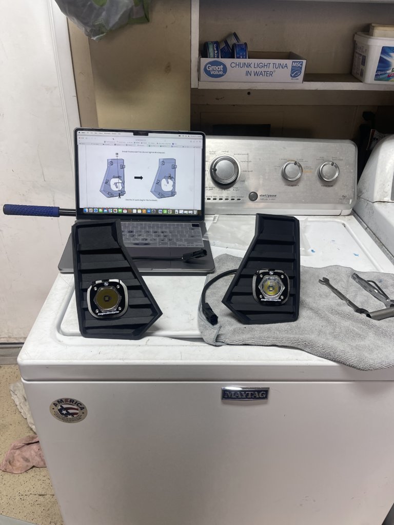

    Im going to do spots in the s1 vent location, they come with wide cornering & you can swap lenses.
    They will give you lenses depending on what you ordered, what they came with, & what you plan on running...
    Im going to do the combo lense in the fog locations so I have wide cornering & spots.
    wide cornering vs spot, 90 feet projection vs 140 ft...
    but spot will be more intense.
    The s1 kit, you can swap lenses after the install so you can easily charge if spots are too much...

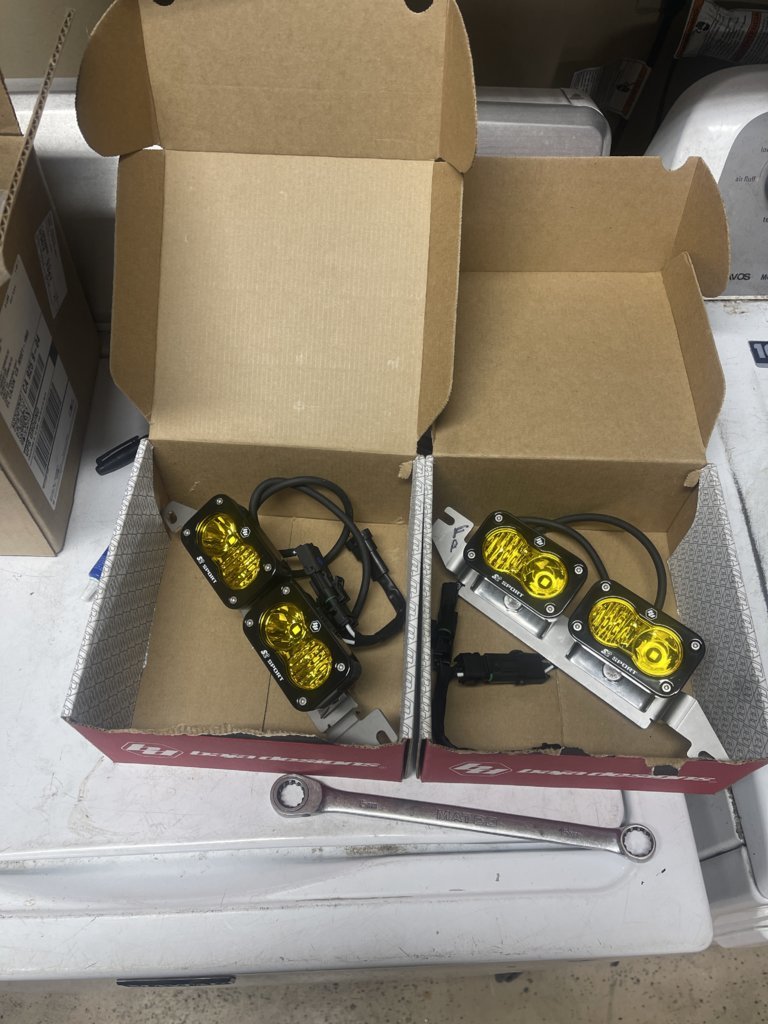

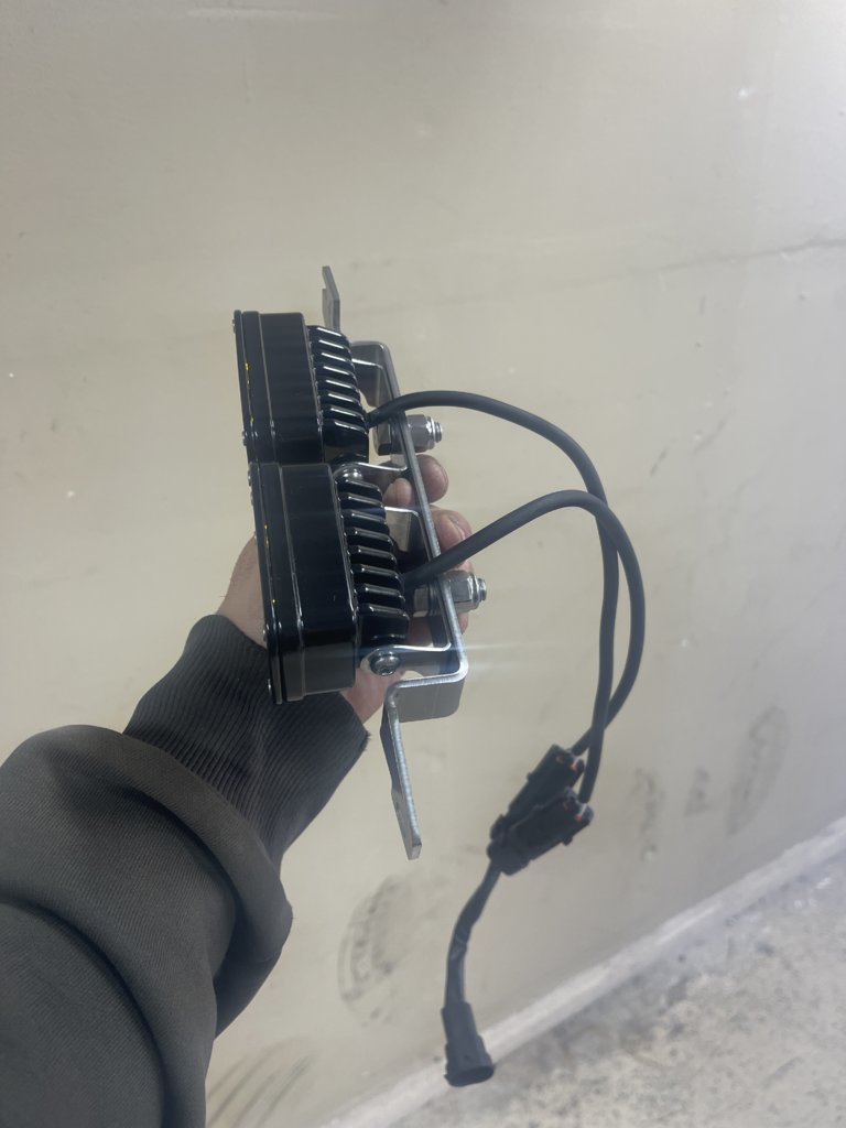

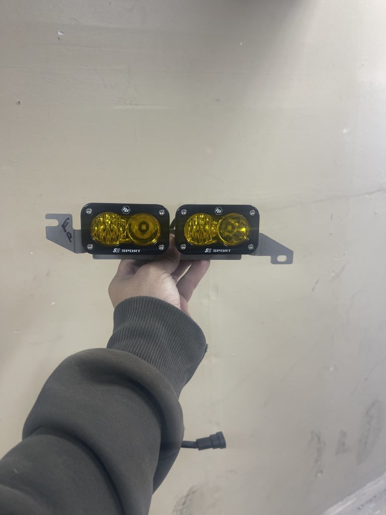

    Swapped the wide cornering clear lenses for the spots.
    Please don’t come assembled, so had to install the brackets and all the mounting tabs on the backside….IMG_8908.jpg

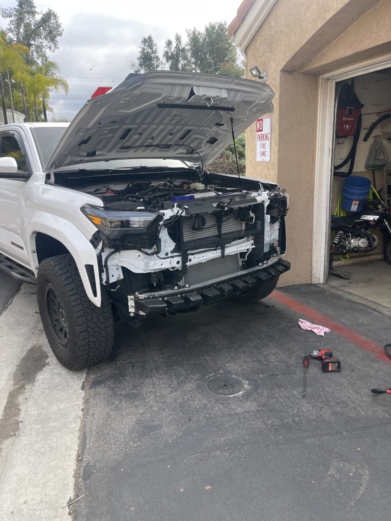

    Hardest part is carefully getting the upper hard to reach tabs to pop on the fender flares, & popping the end of the front clip where they get inserted into the edge of the fenders....
    I did this for a living through, ive replaced thousands of radiators & active grill shutters where entire front facias had to come off....
