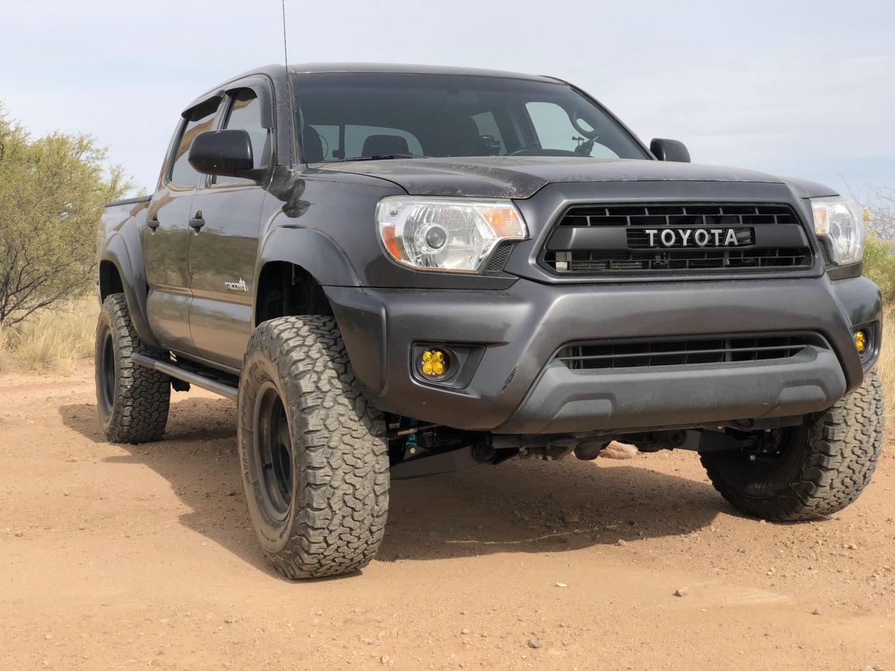

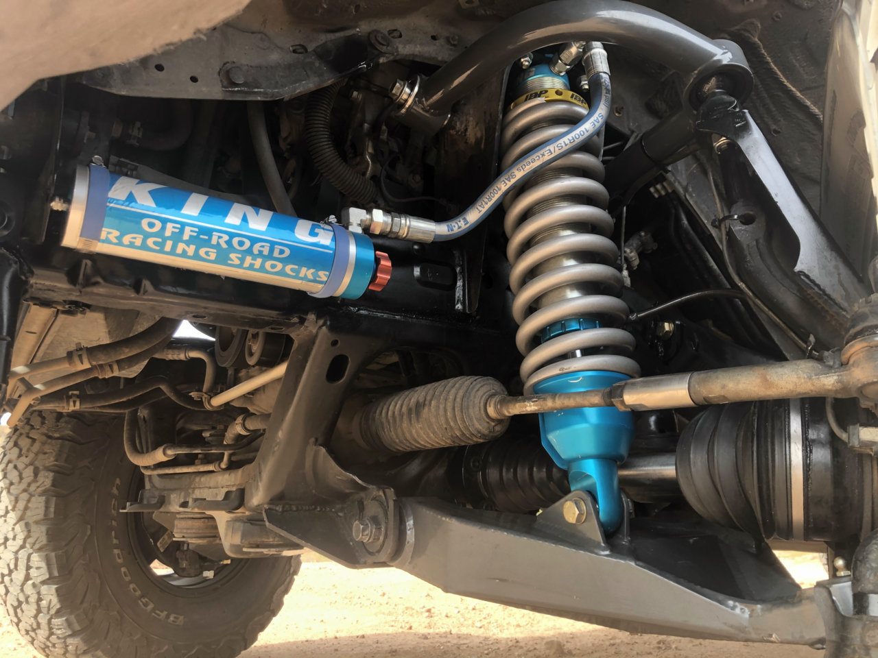

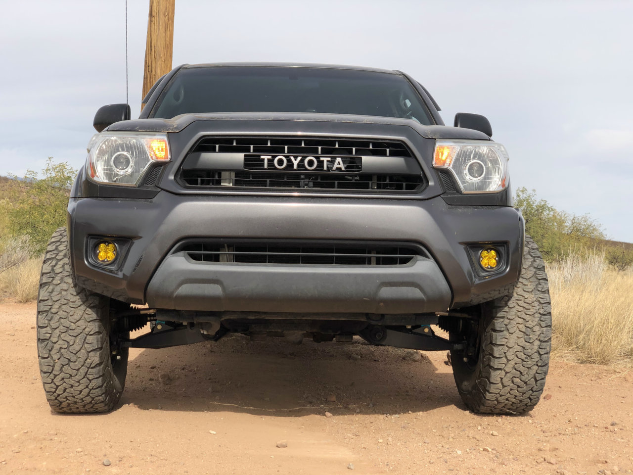

    Lt front/rear Jd fab…
    JD Fab for my use, high clearance lowers and 13" of travel with a smaller +2.25" track width change, big axles, and everything is sealed and made easy to maintain. so good for anything in my opinion unless you wanna go big and wide or racing.

    Looking killer man. What size tires are you running and did you have to trim Even with them pushed 0.875 forward.

    I'm a bit biased but if you are going to go big, do as I have done...JD Fabrication.
    2.25" LT Kit (934 cv), Steering Rack (heimed ends, double shear mount), Howe Steering Pump with 1.5x Quickener, gusseted spindles, LCA Mount, SUA Kit with deaver leafs. King bling all around, upfront has single bypass free bleed. 36gal fuel tank (carb complaint). 35x12.5 on 17" wheels. Alignment at 5degree caster, -0.5 camber. 3' of flex, 19" travel in the rear and 14" upfront.
