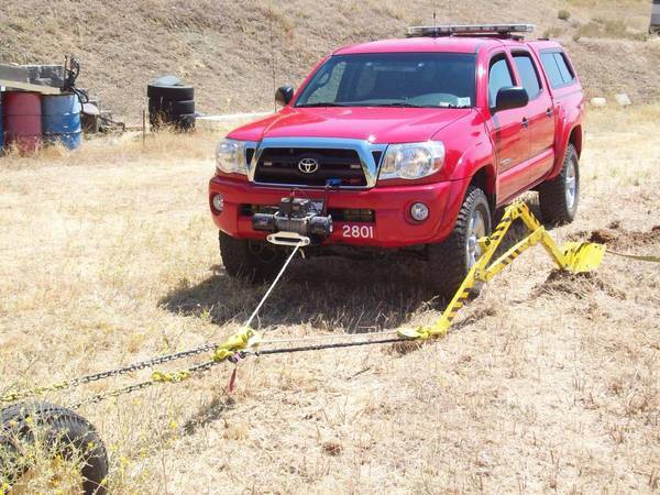

    I like the CBI hitch. Or you can make one like I did for about $80.
    [​IMG]:D
