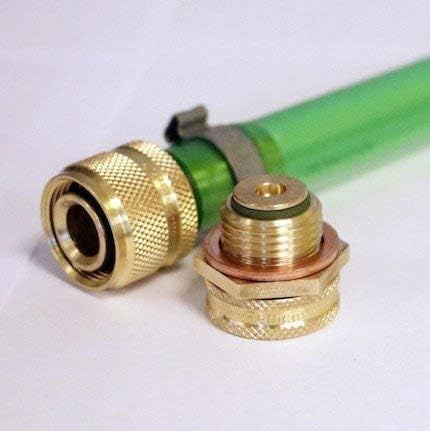

    I’m about to do my first oil change on my TRD Off Road. I’m considering a Fumoto Oil Change valve and since there are 5 (from the Fumoto web site) to choose from I’d like to know which one you all would recommend. Also, was it necessary to pull the rearward pan to install the Fumoto?
    Some older posts recommend the F103 however that model isn’t listed on the manufacturer’s web site.
    Your recommendations are appreciated.

    Yup same here. You definitely do not need to remove the skid to install this.

    I have the F133. F103 is the older valve, f133 is supposed to drain faster.

    I have no experience with the 103, just what others have stated. Fumoto says the 133 has a larger body with a 60% larger drain.

    Yessir the new version is the F133 which drained about 3x faster than my previous F103N. Got a vid comparing the two

    Should fit. According to the specs, that's an M12x1.125 which is the correct thread for 2nd/3rd generation; any damage to the threads anywhere?

    No damage on threads. I could feel it start to cock and start to resist. I compared it against the regular plug which went right in with ease. Tried two or three times. I feel like an imbecile

    Why? It didn't seem right, so you didn't push it, and now you haven't f***ed up your drain beyond all recognition. It's possible that the Fumoto valve has faulty threads, might not readily apparent. Have you had your truck since new? Any chance someone previously messed up the drain and put in a Helicoil with a different thread pitch?

    Yeah True. And I didn’t keep trying because I thought it was the wrong part number after a quick search but I found this thread that the F133 superseded the F103. I am not the original owner, this is my second oil change. Side by side they didn’t look any different.

    It is quite possible the new valve you have has flawed threads. I would try to exchange it and try again.

    Go buy an M12 nut and test fit the fumotomomo. Or just go to the store and try it.

    If you have a thread chaser or M12x1.25 die, you could try cleaning up the threads.
