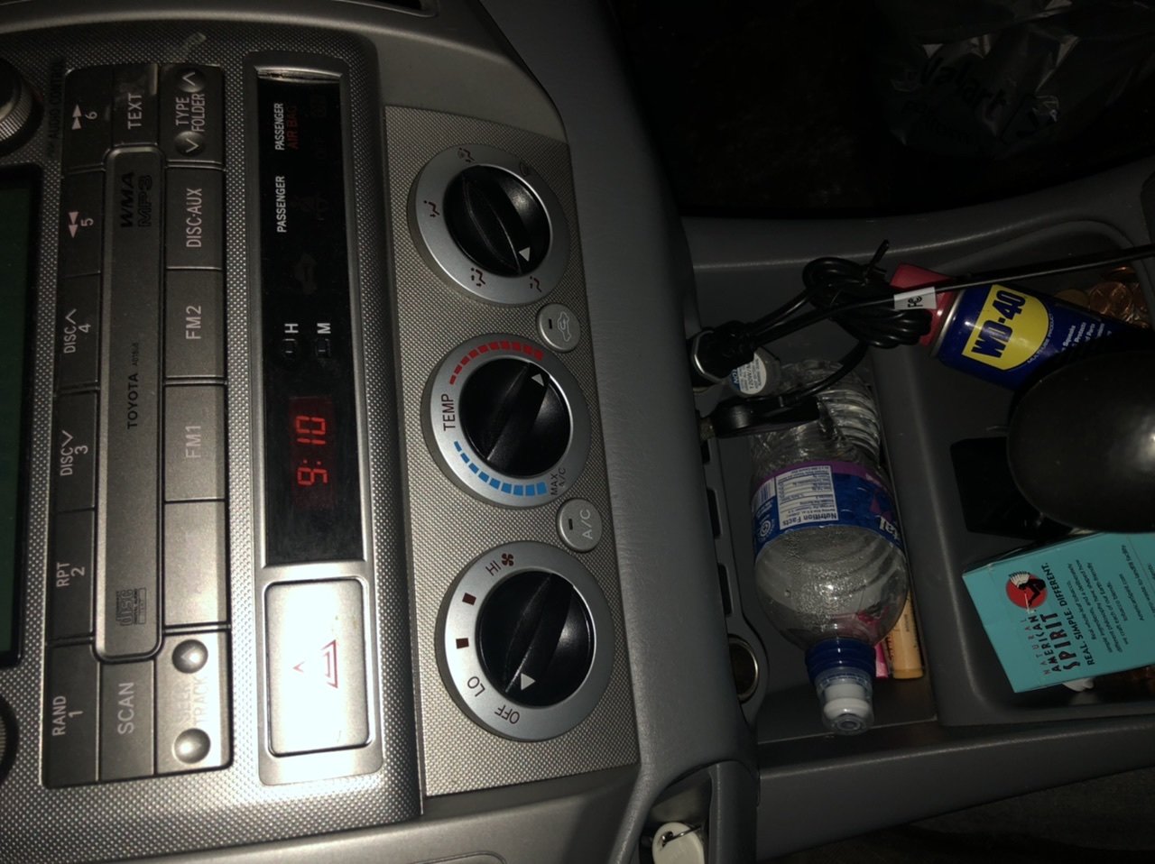

    Does anyone know which fuse I need to replace to get the lights on the ac/heater control knobs to work again? Thanks!

    The climate control lights are powered off the tail light fuse.

    The bulbs are likely burned out.

    Plastic knife from a McDonalds breakfast.

    The bulb has the base on it so you replace the whole thing. They twist out with a smaller flathead screwdriver. Simple straightforward job.

    You can easily improvise with plastic cutlery as suggested, but there's also stronger (and cheap) plastic trim panel tools for sale on Amazon/HarborFrieght/Autozone. Just make sure you use plastic so you don't marr the console up.
    You'd be suprised how handy these tools can be: https://www.amazon.com/KINGLAKE-Pan...rds=plastic+trim+tools&qid=1577801791&sr=8-15
    Bulbs don't come out of the socket, the whole assembly screws in and out for replacement.
