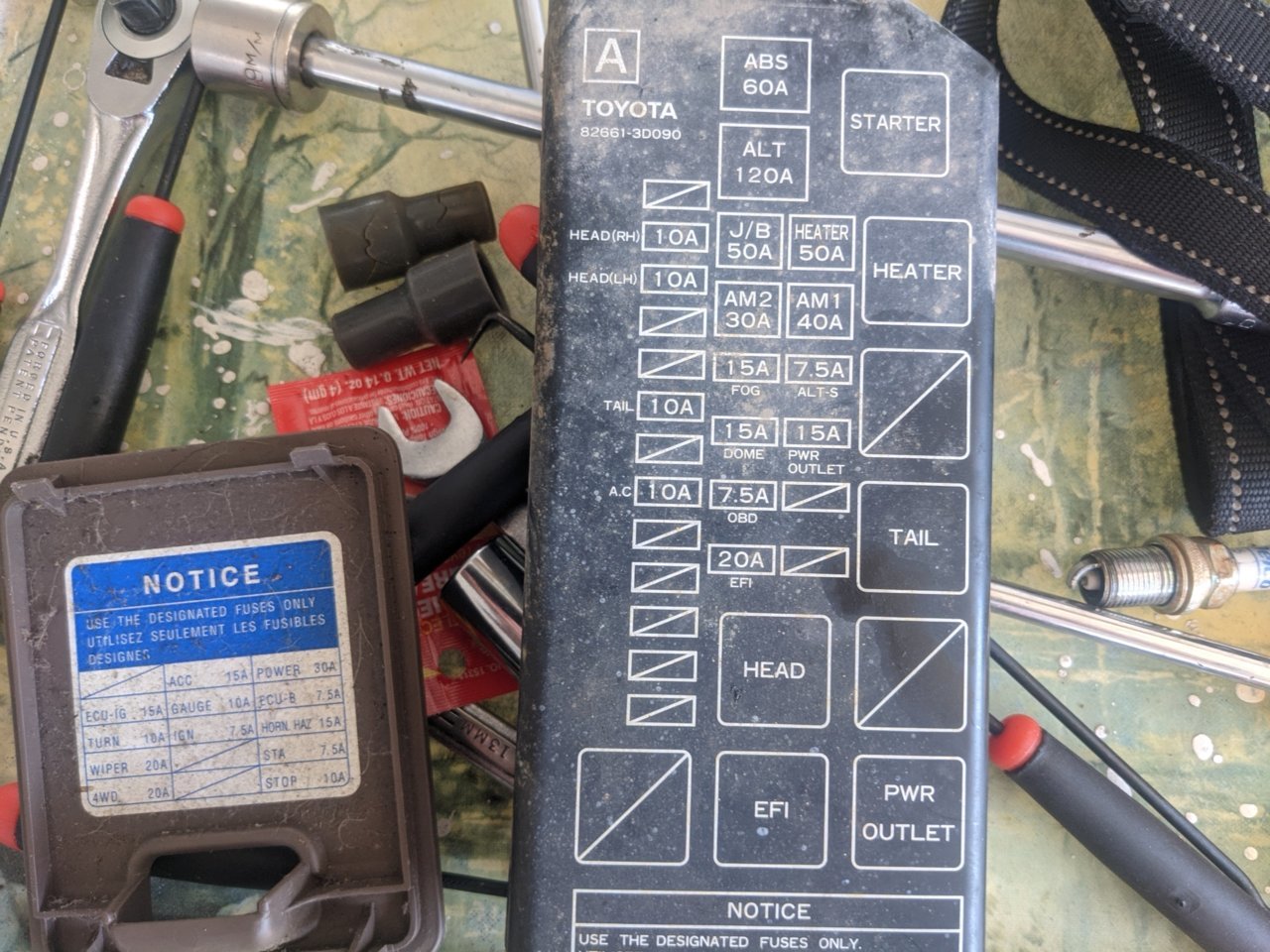

    I know nothing about mechanics but am learning, so forgive a stupid question.
    Which fuses do I pull to disable fuel/spark in my 2002 Tacoma, 2.4? I think I have the fuel part figured out--it's the one in the cab for the fuel pump. What about spark? Thanks.
  2. Jul 28, 2022 at 12:56 PM
    digcolnagos
    digcolnagos [OP] Member
    Aug 26, 2021
    #375312
    21
    My bad. It's the EFI, I think, which for the life of me can't figure out how to pull. It doesn't just come unplugged, and no instructional video I can find anywhere.
    Help, please.

    If you have the fuel pump fuse unplugged that is good enough and don’t need to pull any other fuses.

    Thanks, but still no help. Video says I have to do spark, but can ignore fuel pump. Took out the IGN fuse from cab and the EFI 20A from the engine compartment fuse box. Won't crank.

    Try putting the IGN fuse back in. Then pulling the EFI relay.
    Unplugging the coils should kill spark.

    Efi. Bottom center haha

    You can either do it like the manual says, and press the gas ALL THE WAY DOWN, and then crank the truck.
    Or pull the EFI Relay. Then let the truck run until it does. (If it even runs at all)
    Then preform compression test.

    Did you watch the video or read the links and FSM which have been posted? You don't have to remove any fuses. Just remove the spark plugs and coils, like the shared resources have all directed.
