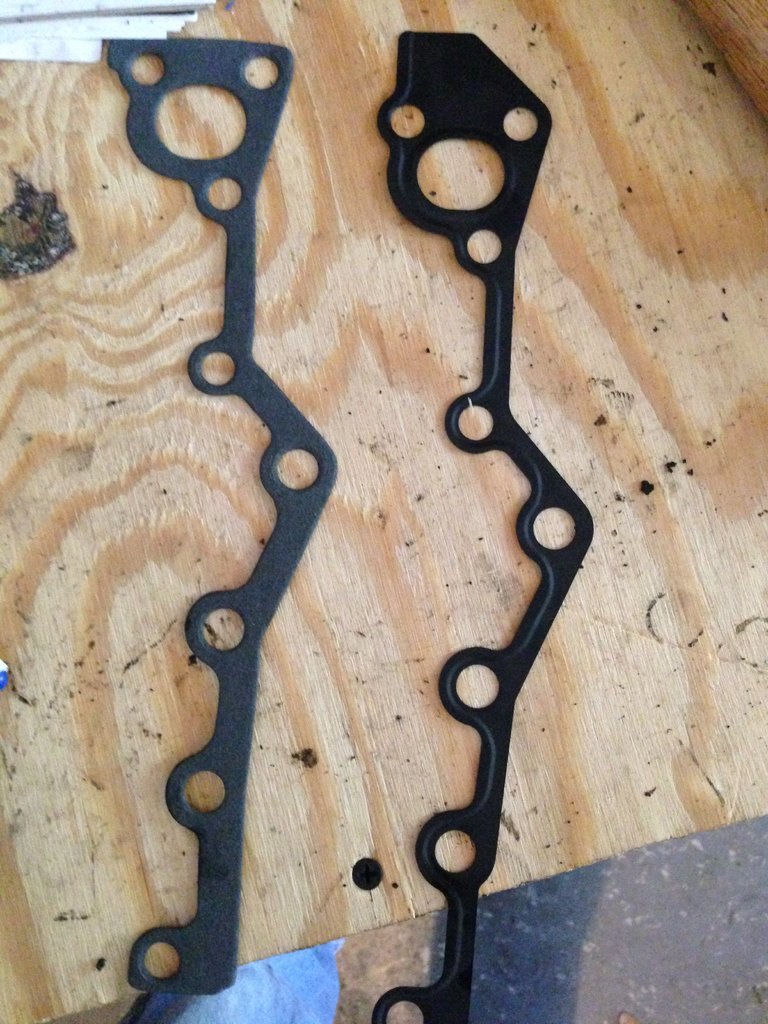

    I got a complete engine gasket set trying to stop oil leaks. My set came with two types of gaskets for the timing chain cover. It came with a metal one and a paper one. Which one is recommended that I use? Thanks!

    I would use the paper. Metal one is really picky about imperfections in the cover sealing surface.
