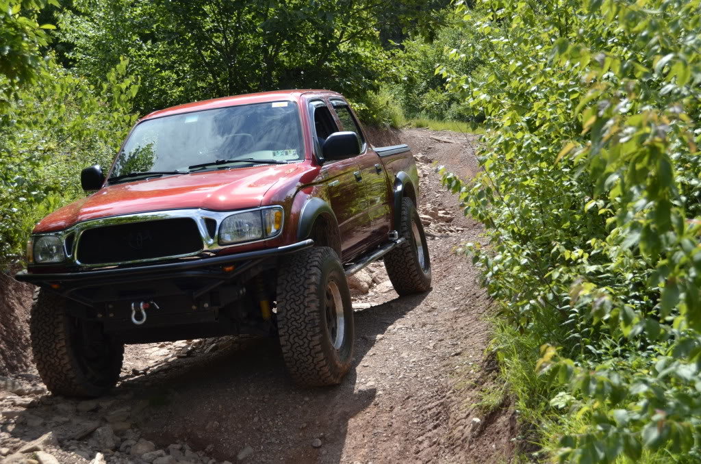

    I never did a build thread on this forum. You can visit it on here. It is not totally up to date though. I have since added OME 882 coils, the axle relocation plates, wheel spacers and 285/75/16 tires.
    This is what it looks like now:
