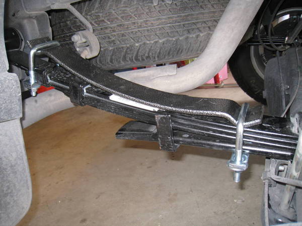

    If you have the 4-leaf TSB leafs, the keepers do kind of get in the way. Here's a pic of mine......

    I am calling Hellwig today. I thought about bending the tops of the keepers up. I would rather the Hellwog sit on the top leaf

    talked to Hellwig today. There are 2 choices. Get rid of keepers or do like i will and bend the 90 out of the top. Uboats in helper will work as keepers. Might not be what you want you want to hear but only way to make them right. I was already thinking the second option and offered it as solution.
