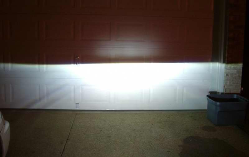

    if you want HIDS but dont want to blind oncoming traffic, you need to do a projector retrofit which will give the light a clean cutoff line rather than scattering the light everywhere (which looks like you have your brights on).
    here is an example of a clean cutoff (projectors)...
