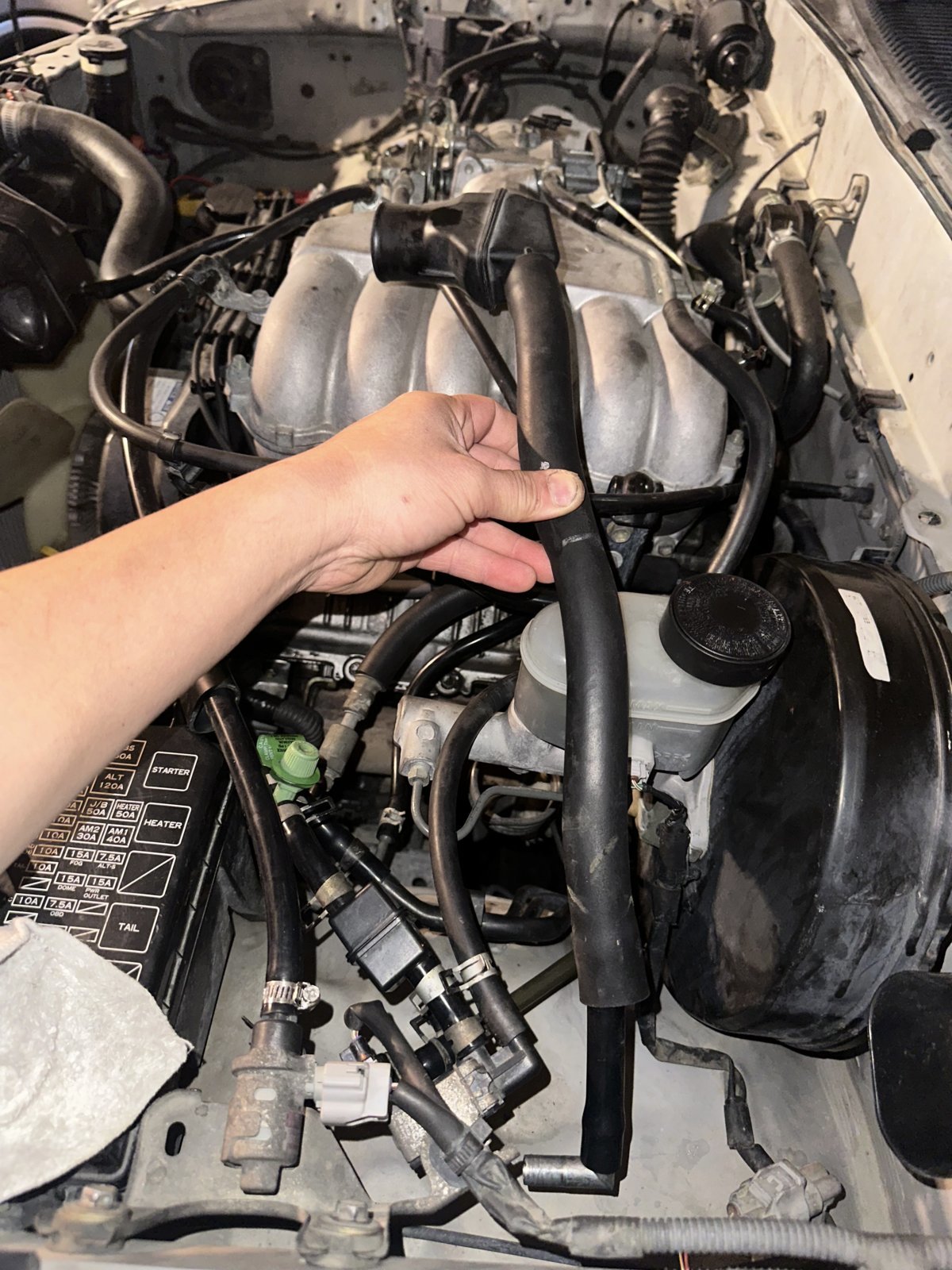

Which hose is this?

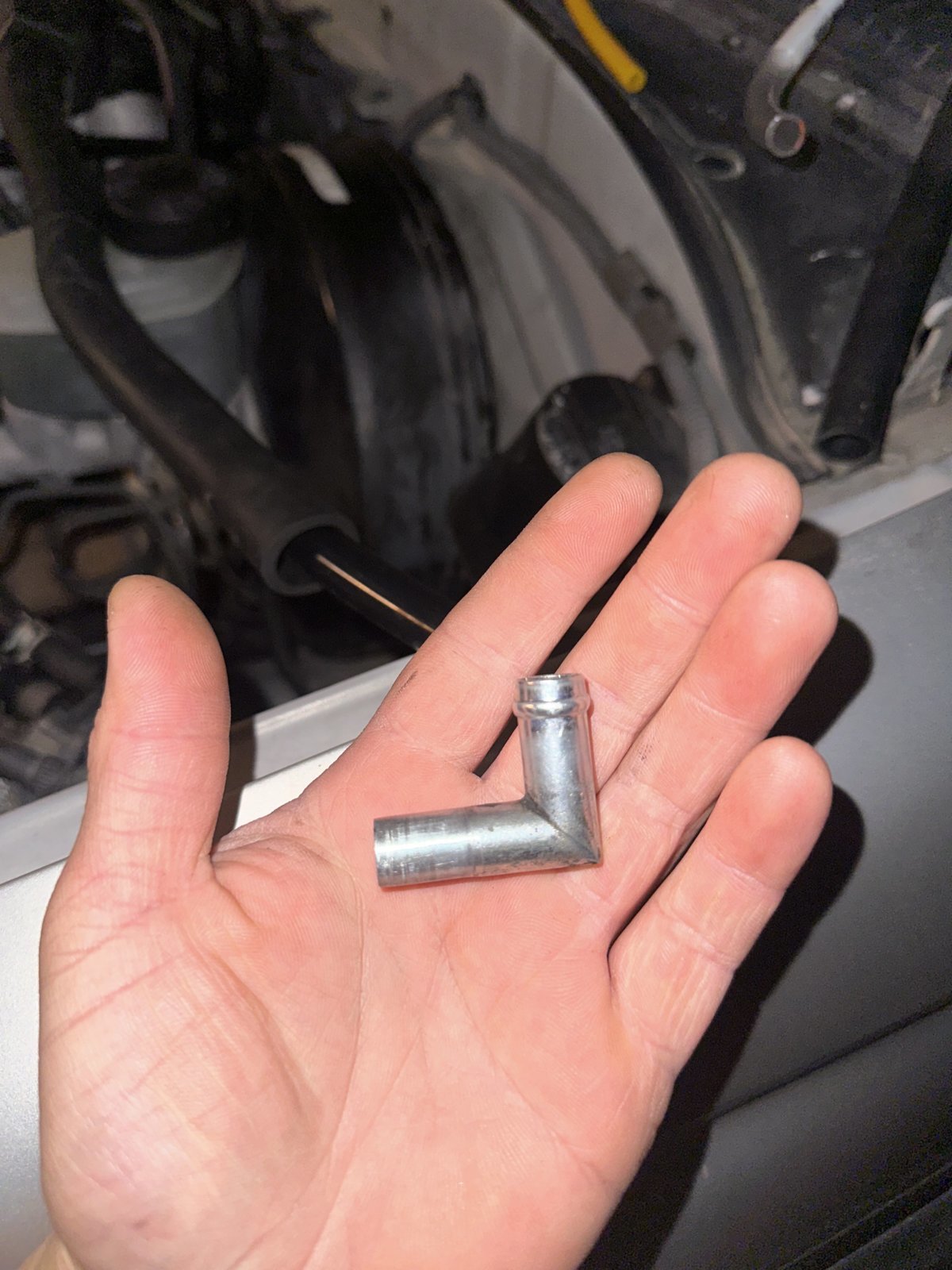

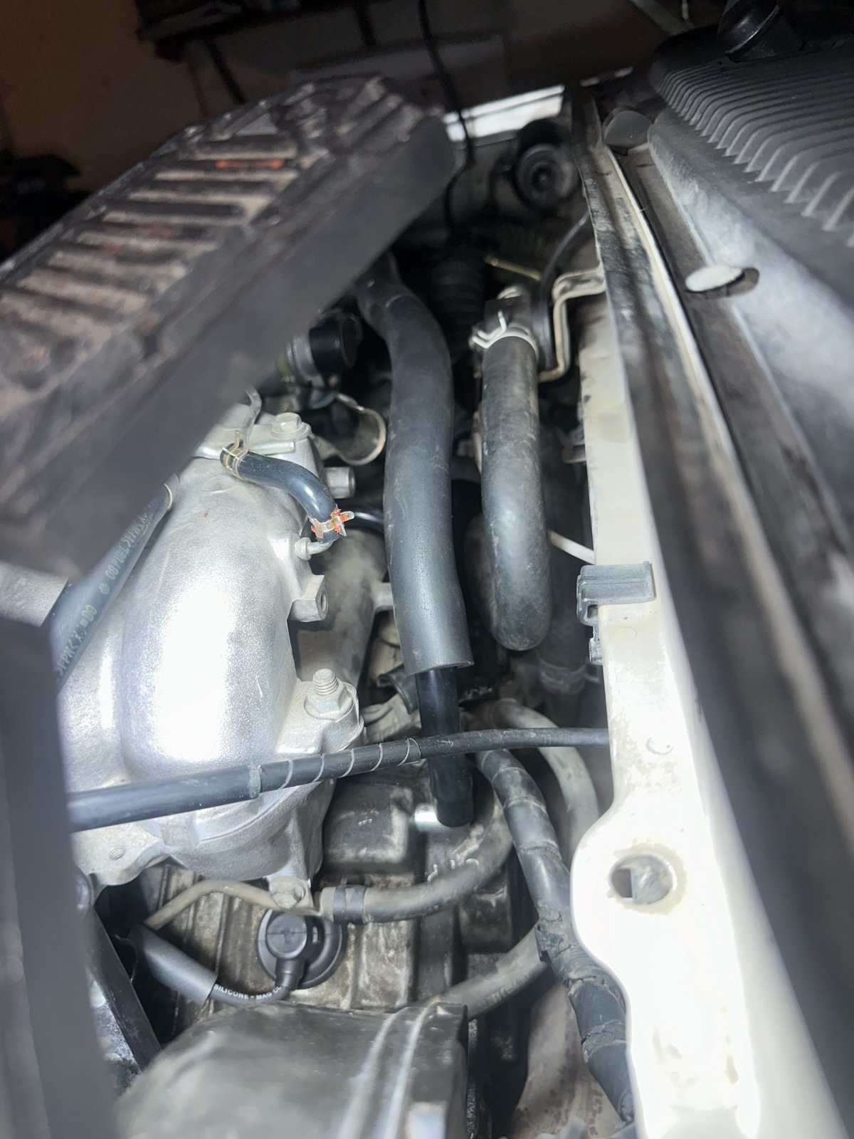

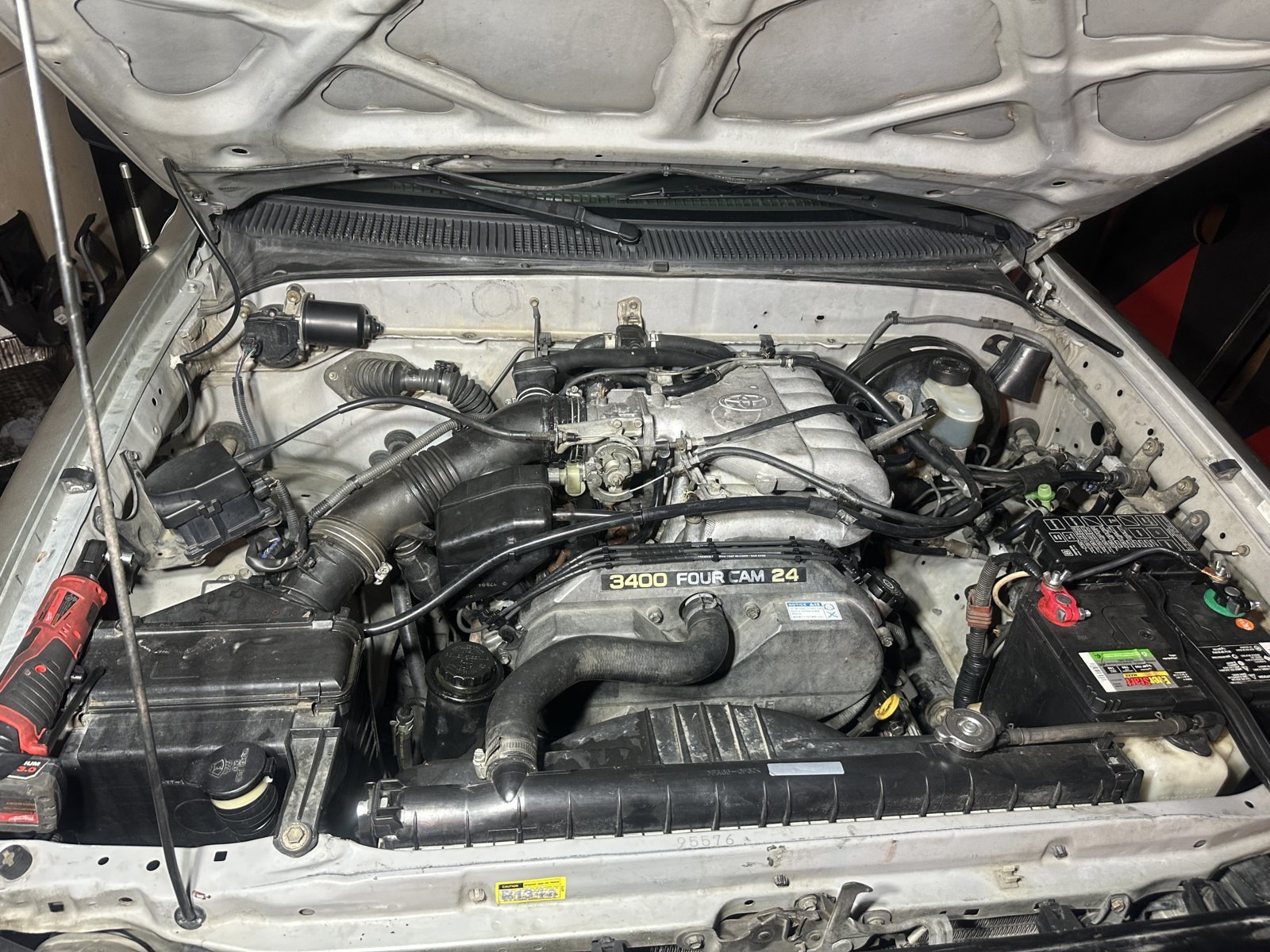

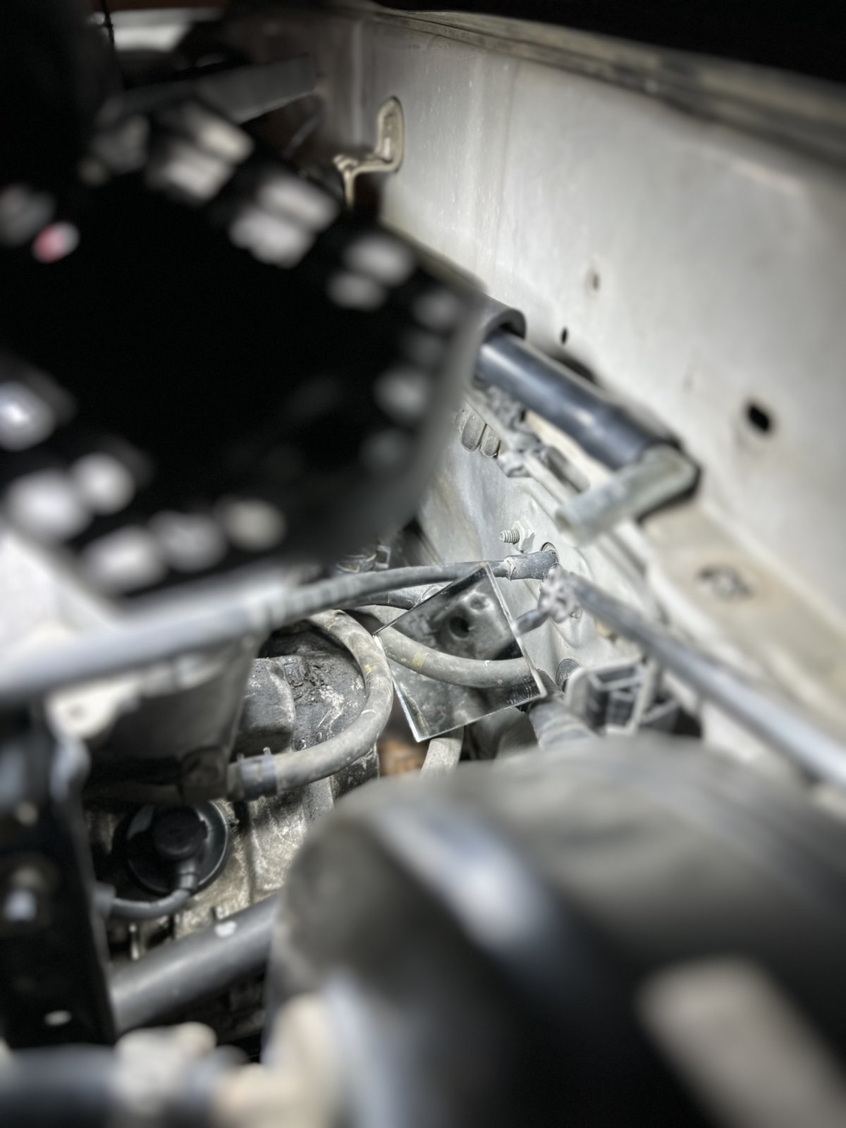

    Hey what’s up? Wondering if you could help after seeing your engine bay setup is just like mine? 02 Prerunner dbl 3.4. The breather hose from the intake air hose that runs into the rear of R intake manifold. It’s plugged to a 90° hollow valve/fitting of the R manifold. Do you have the part number or know of what I can use in place; and is that thing supposed to slide right off because mine does. Can you shoot pics of under the hood with sections of the hose diagram? Looking for something really detailed has been difficult. I’ve attached pics of what I’m asking

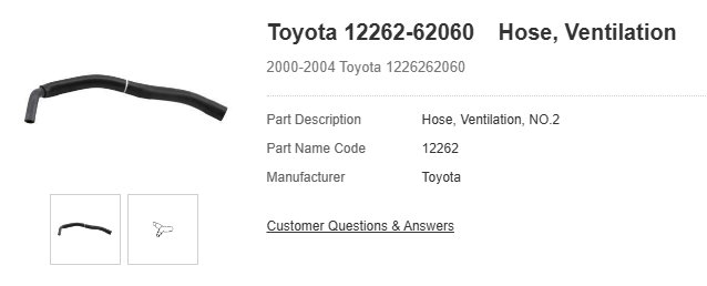

    It's part number: 12262-62060 Ventilation Hose No. 2. The diagram on the toyota parts store is misleading- shows a 2.7l.. but Toyota Parts Deal has the correct image for it:
    It's pretty damn expensive for a hose. I wouldn't pay that, and just get some silicone vacuum line and send it...
    Here is a thread where I asked about this awhile back. Contains some good information about the PCV system on the 3.4l
