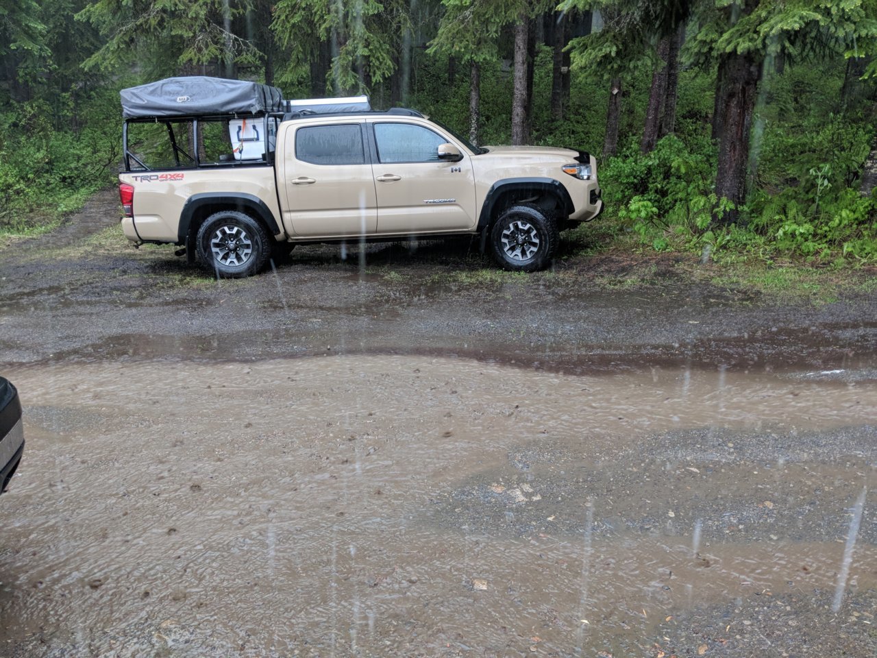

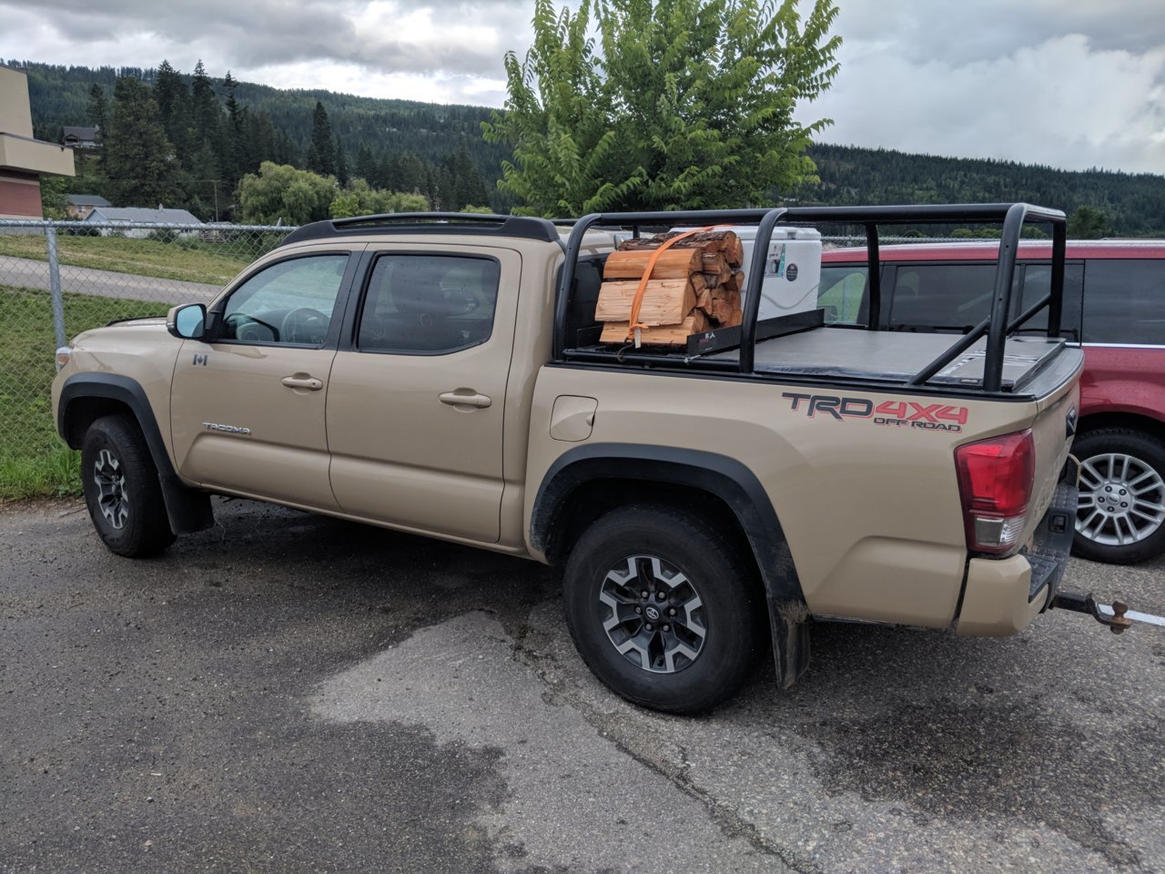

  12. Apr 29, 2020 at 5:33 PM
    KkelX4
    KkelX4 Well-Known Member
    Jun 17, 2017
    #221720
    751
    2017 Tacoma TRD OR
    RTT Rack
  13. Apr 29, 2020 at 6:29 PM
    Soylent Green2012
    Soylent Green2012 [OP] RestoRides MotorSports
    Apr 4, 2020
    #323842
    276
    jake
    Apopka, Florida
    2012 Tacoma Pre runner SR5 V6 Limited Edition
    chrome bull bar, 20" vision wheels, LED lighting, Custom grill.
    That is awesome, Excellent. I can see tons of options with this in place.
  14. Apr 29, 2020 at 7:32 PM
    KkelX4
    Jun 17, 2017
    #221720
    751
    2017 Tacoma TRD OR
    RTT Rack
    Yeah i made a jig out of 1/4 plywood for the outside edge shape of the pipes then i bent my pipes to shape of the jig. I used 2" aluminum pipe i think.... 1 3/4" ID. IIRC...
    Used aluminum cause you can cut it with a carbide blade on a mitre saw. That way i could make jt all with the tools i have. Then i got my buddy to weld it all up. With my help we probably had 4 hours of weld time on it. I prepped all the welds so all he had to do was run beads. If I had paid him i would have been into the main rack for less than 500$. Had it powder coated black for 120$.
    Pro tip the closing weld on the pipes needs to have a place for the heated it inside the pipe to escape or it blows out the welds. Drill a hole on it anywhere.
    Oh yeah in CAD so im guessing cheaper in the states...
