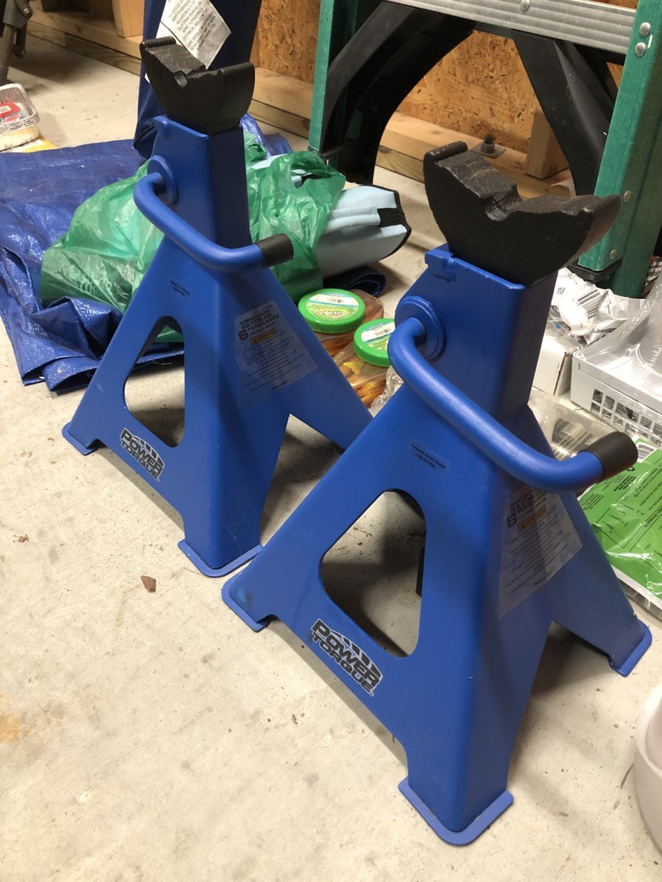

    I have Power Torque 6-ton stands. These were excellent when I installed my 2-inch lift, still had plenty of room to go up.
    wi_taco and TnShooter like this.

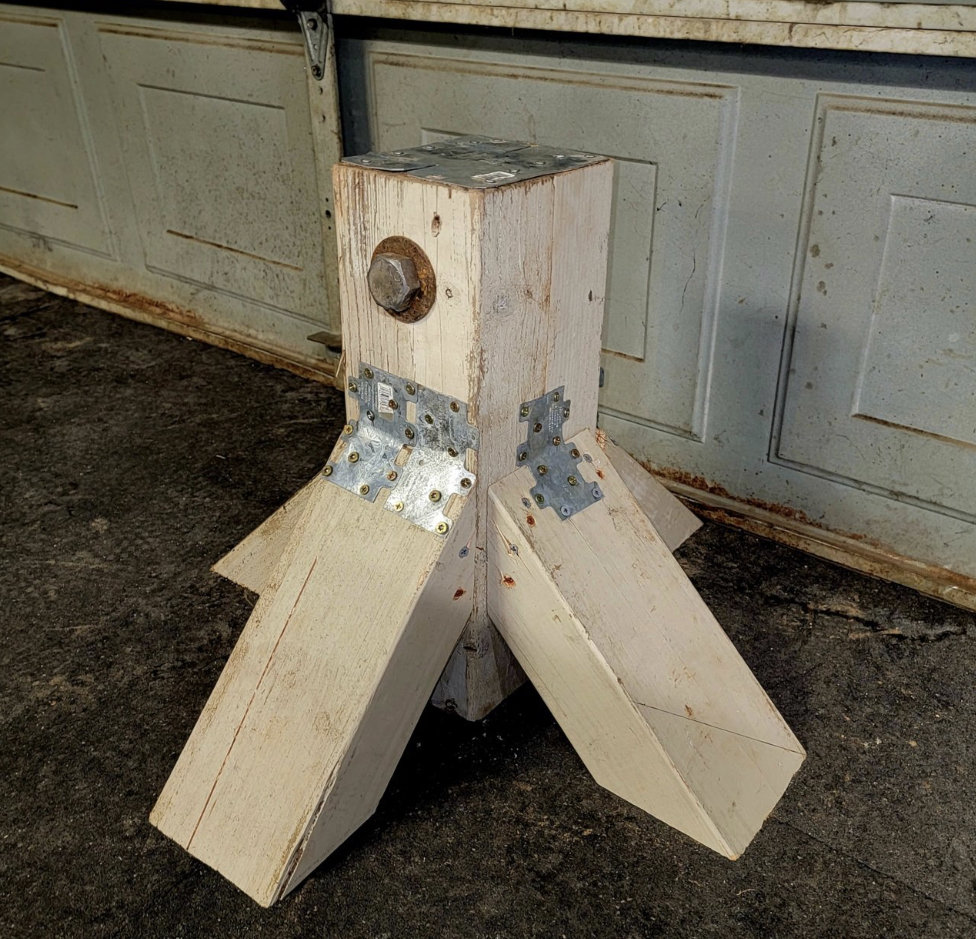

    death trap
    GingerSasquatch, Micbt25 and Squirt like this.
