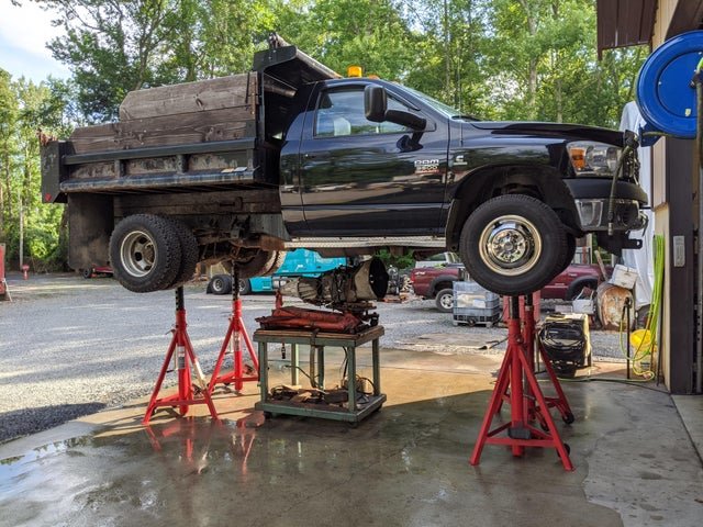

    What I wana know is how they got it up there lol.

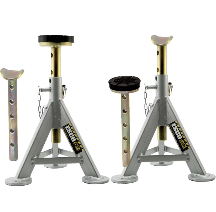

    I have these ESCO, heavy and sturdy best around imho. Expensive but hey I’m worth it.

    I like the pads.

    Same way as the pyramids. Temporary earthen ramps and 20 thousand laborers.
    That or a big honking forklift.

    Acoustic levitation. Duh.
