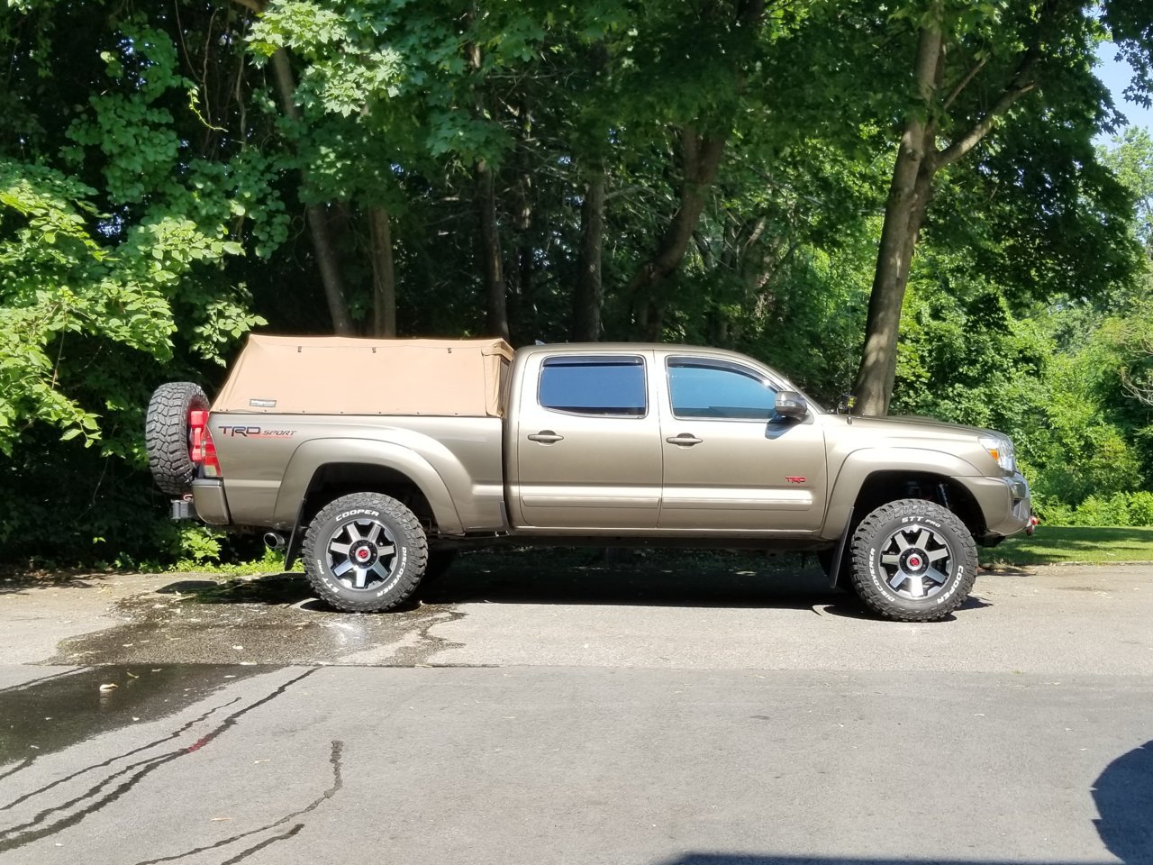

    Exactly what I did, I went with 650's set at 2.5 but adjusted the driver's side for the lean.

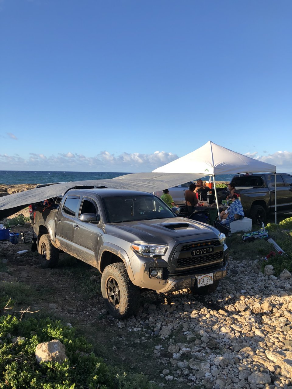

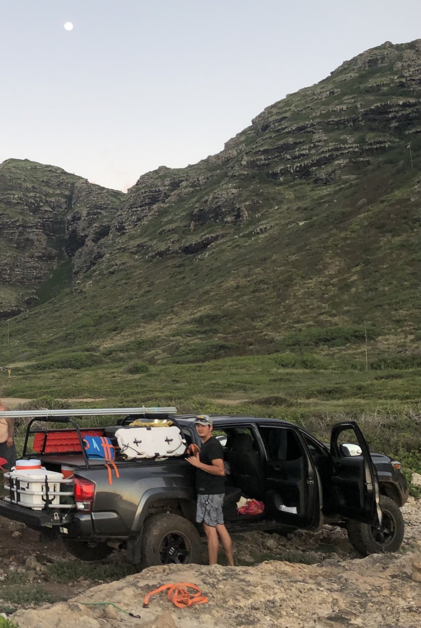

    I'm on vacation right now so I'll have to take hub-fender measurents when we get home but my ground to fender with 265/70/17 tires was between 39.5" - 40" and I know for a fact I was sitting at around 35 7/8" - 36" prior to lift and tires. No idea how I'm getting so much lift in the rear.
    I'm down for rake. I honestly like the look of rake more than I do leveled. But I've got 2" of rake AT LEAST and that's because the 888s are sagging like old tits. So I decided I was gunna ditch um and get adjustable coilovers and this forum peer pressures everyone into just buying the best so that's what I'm doing.

    Like I'm on clouds honestly. Winch with synthetic cable goes in this weekend. Hopefully it doesn't change the ride to much.
