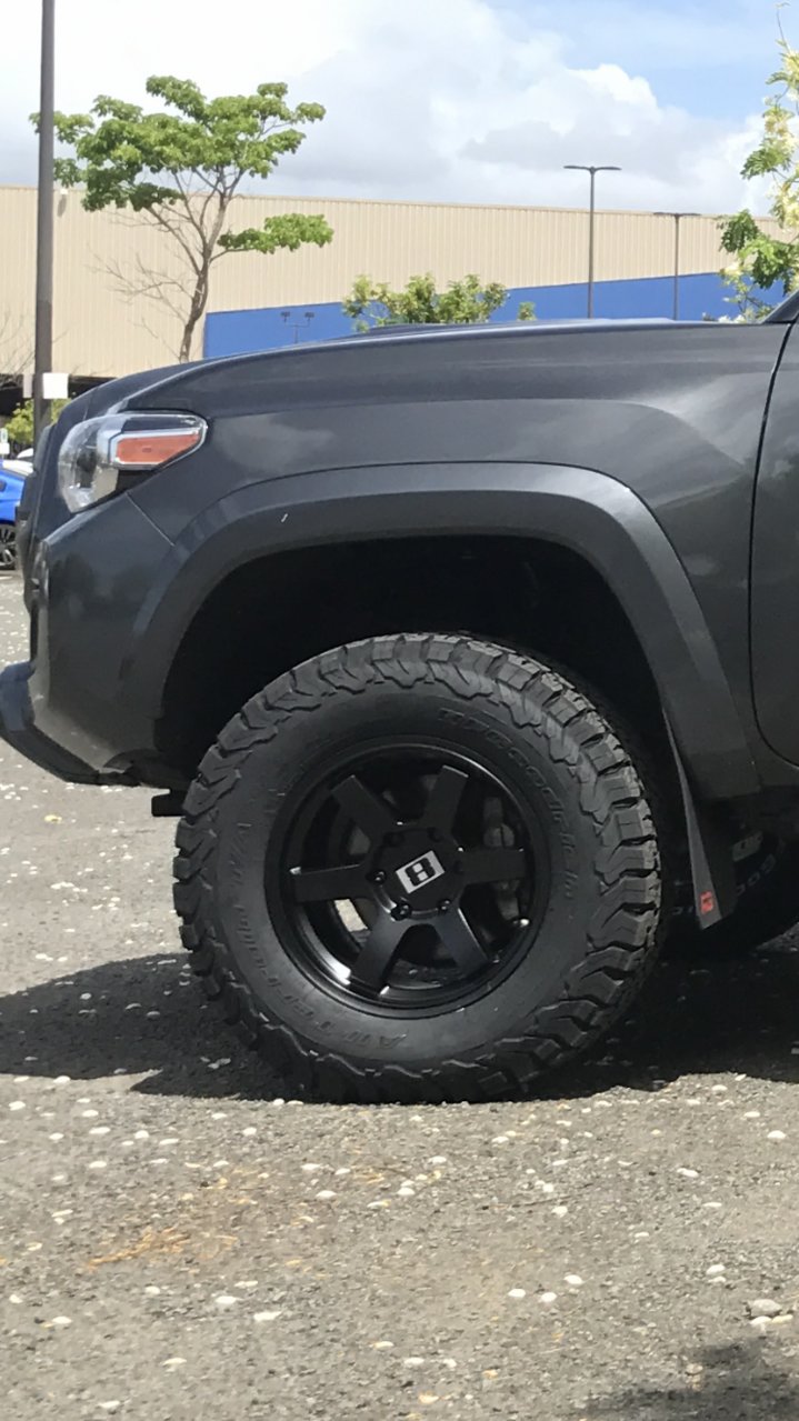

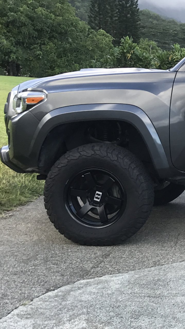

    22.5" both fronts hub to center.
    I've got a buddy at work with a stock TRD. I'll try getting hub to fender measurements on his tomorrow. There's no way I'm only on a 1.5" lift with 888 coils.
    When I had 5100s preloaded to 1.55" lift with my 265/70/17 tires I was consistently at 37" ground to fender.
    I'm at 37.5" ground to fender with the exact same tires morning, day and night.

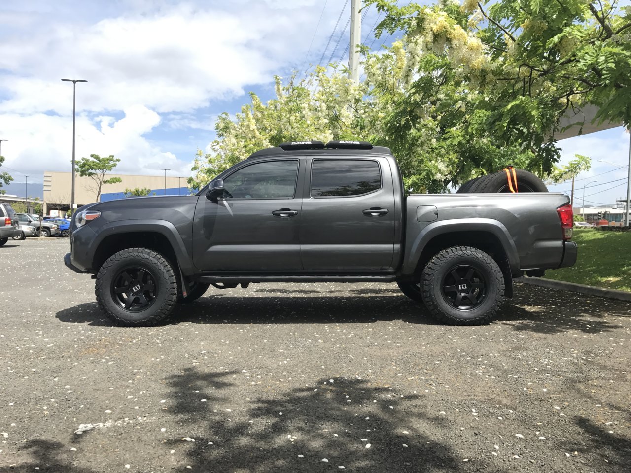

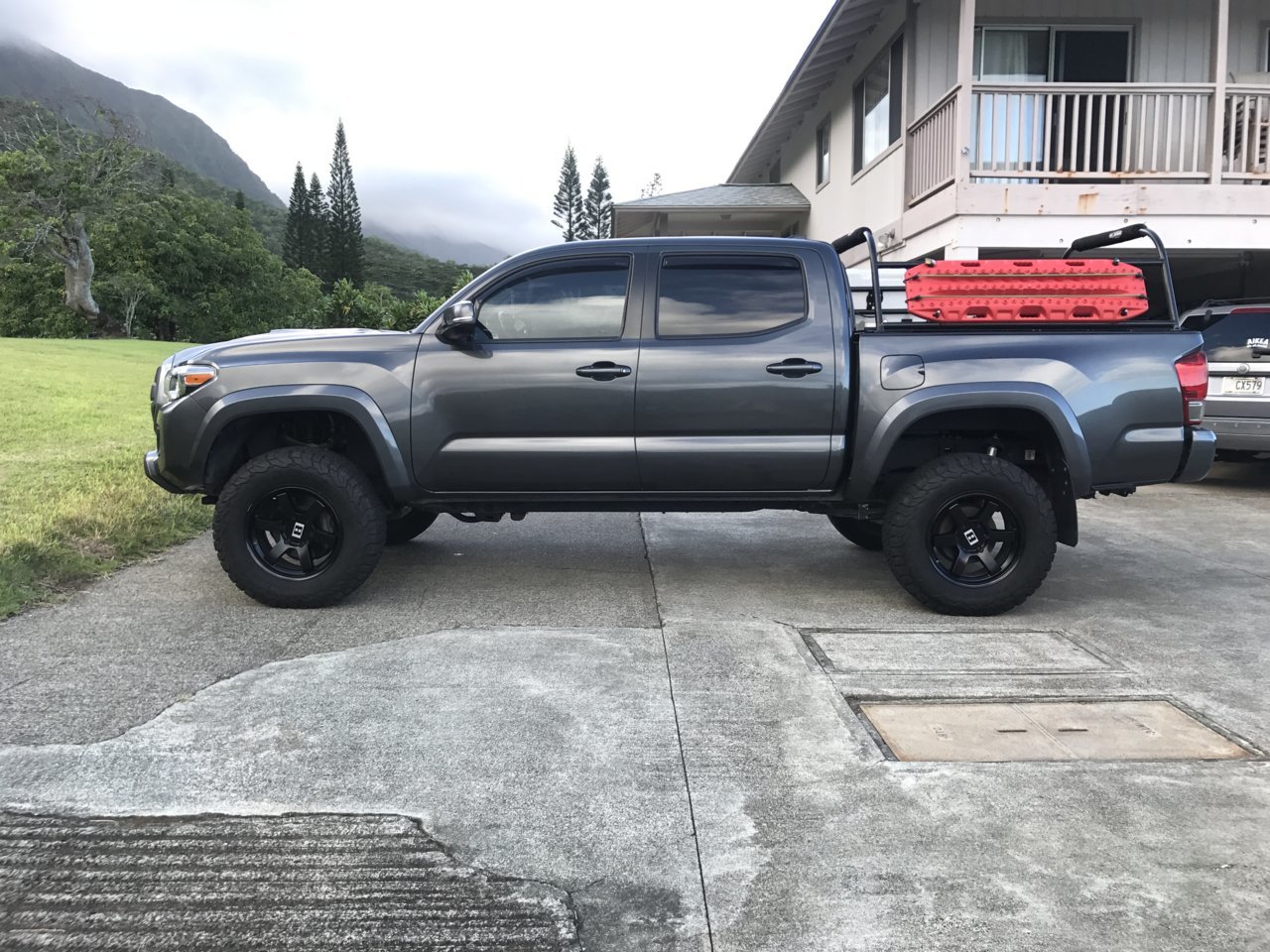

    I can't believe that 22.5" would be a 1.5" lift because 5100s on the 4th notch is 1.55"
    This is what it looked like on the 4th notch

    I know. I know. Super scientific way to compare lol

    I’d have to lay these shots on top of each other in photoshop, but...Looks the same to me. You also have a bedrack on in one.
    Whatever it is, it’s negligible. There is no difference in 1.5 vs 2”. It’s literally a finger width. If anything. 1.5” will ride nicer, but both will perform evenly, offroad, for the common driver

    I have a 1" lift in the top picture and HD Dakars in the bottom picture. The rack doesn't do anything to my suspension.
    Also my measurements have changed half an inch from picture to picture lol.
