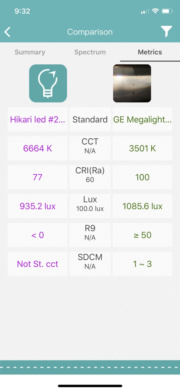

    I'm in the middle of it now, although he is only testing one LED bulb so far

    The results I’ll share tomorrow in that thread will shead more light on it for you. LEDs do not project in halogen housings, even normalizing for poor output performance. Bi-directional lights have very poor output efficiency and worse distance projection compared to omni-directional ones like halogen and HID.
