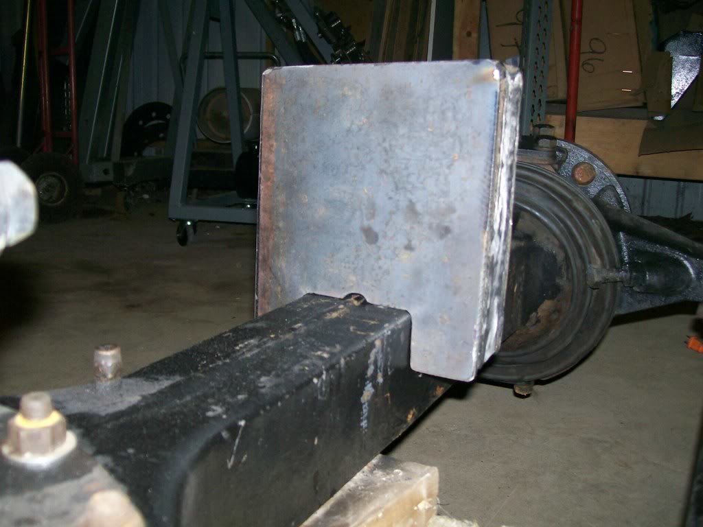

    If you use aluminum blocks, you should add at least an additional inch since aluminum will flatten out over time due to it's soft characteristics. Here's what mine looks like.
