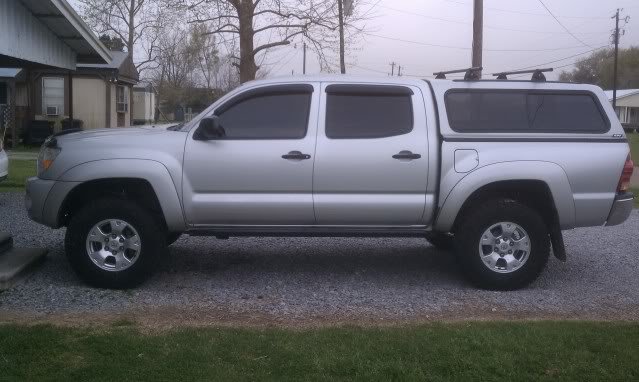

    5% Tint, Bug flector, vent Visors, Removed secondary air filter, Rear Spring TSB w/ Wheeler's Add A Leaf HD Pack, Icon 2.0 rear shocks, Toytec 3" lift up front with Total Chaos UCA's, Debadged, Billet Grille,TRD Offroad rims/17x9 Pro comp 6001 rims, Duratracs 265/75/16 or 285/70/17, Fog light anytime mod, Tailgate hose clamp mod, Pro-dry AFE filter. Extended Differential Breather, ABS on/off, 6000k LEDs from CSJumper, heads/fogs, ScanguageII, Devil horns, Devil horns on third brake light, Mounted 60" Highlift, Mounted Tool Box, Wet Okole Front/Rear Seat Covers, TW sticker, Midland Handheld CB,Painted engine cover, Revenge Fab Sliders, ARE Topper, Weather tech Floorliners, Camper shell, ultimate headlight upgrade. URD -3° exhaust cam gears, .5" XTP Intake spacer. Custom dents.
    toytec 3" lift, rear spring TSB, ARE shell about 133 lbs.
    Small tool box in bed about 90 lbs
    60" hi lift jack mounted
    265/75/16 Duratrac
    In all honesty I'd wait and save up to get as best a lift as you can or you could be like me and now saving to purchase the better lift now.
    I now have the Wheelers 3 leaf HD Progressive AAL pack and Icon 2.0 rear shocks
    Waiting to purchase my 2.5 Resi Icon coil overs for the front.
    You get what you pay for rings true here.
