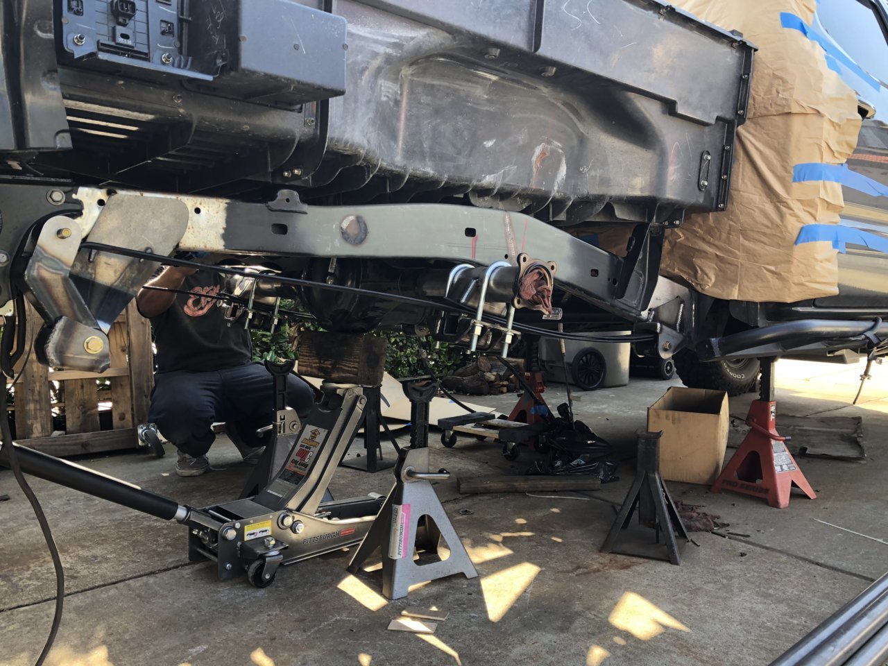

    dmz :thumbsup: tim is legit he will answer all your questions and go above and beyond
    Dmz sua going on my truck right now but my buddy made his own shackles for me to yield more droop

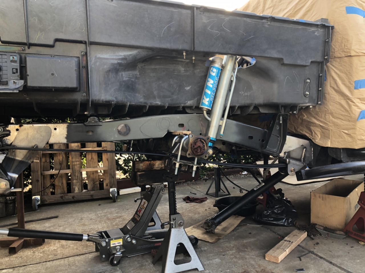

    More updated pic still lots of work to do though
