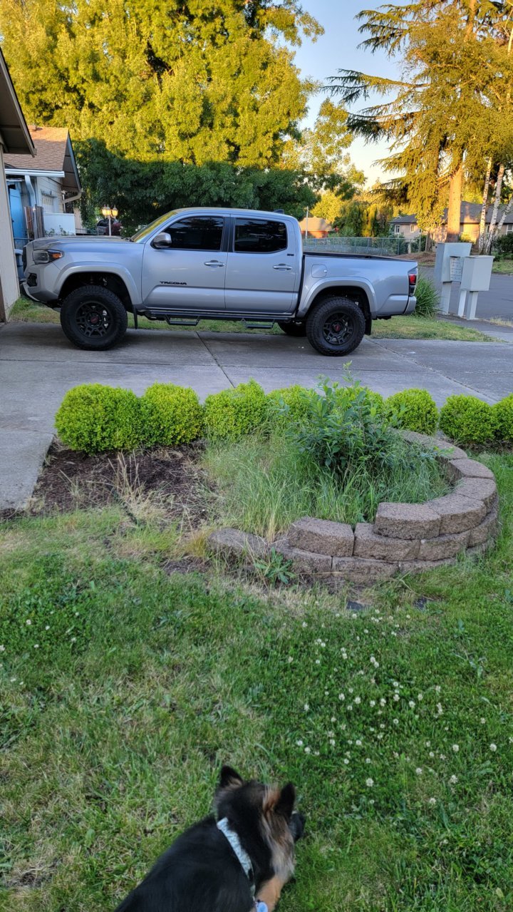

    I'm not saying this is THE best option, but this is what I did.
    1. TRD Lift Kit: 2" front 1" back. Bilstein 5100s all around
    2. Trd T4R Pro wheels 17x7 +4mm offset matte black
    3. 275/70/17 Falken Wildpeak AT3W
    285s won't fit with this lift with those wheels without trimming, cutting, new ucas, or other modifications

    You truck looks bad ass !that’s how I want mine to look ! , how much did the total parts a labor cost for the Trd lift ? I was looking into it but some dealers charge over 1000 just to install plus the parts
