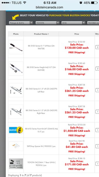

    Front Suspension King Ext Fronts 700# Icon UCA delta joints JD fab spindle gussets All Pro cam tabs DuroBumps Warfab steering sleeves Rear Suspension Old Man Emu leafs -Radflo Ext travel rears Timbrens ubolt flip kit SCS stealth 6 Wheels 35x11.5 Maxxis Razr [ 34.5 x 9.75 on 8.5 rim not on truck] Heavy Stuff Relentless front bumper Smitty 3rd Gen winch Big County Customs skid plates Arc One industries rear HC bumper RCI sliders Misc Arb dual compressor Arb rear locker Pelfreybilt fuse panel tray Cali raised ditch light mounts Cali raised bed stiffeners 5th Gen 4runner LED fog lights Racks Retraxone XR tonneau Yakima load bars Sherpa Roof Rack Camping Smittybilt Tent Dometic CFX50 fridge
    You can buy bilsteins from pretty much anyone online or in person.
    I got the 3rd gen Tacoma version part numbers listed below in photo. CAD prices listed. However I went through 4wheel parts, cause I know the guy there, & it was Boxing Day sale. $710 taxes in or like $50 American. Got a 1 inch block as well because dakars squeak, and like the silience that the stock leaf springs give me at the moment. Once that changes I'll upgrade.
    Rides better than stock. Turns better than stock. Best quality shocks in the world nope, but they sure kill the $10 hitachi ones that came with the truck.

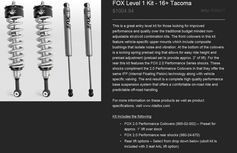

    to those that posted the link for the fox setup for around 1k. thanks for that.
    thinking max 2" setup, but this shouldn't require any of the AAL options correct? she just wants a mild 1-2" lift for around town winter snow and tame back roads to hunting spots.
  20. Jan 10, 2017 at 6:38 AM
    #60
    Doggman
    Doggman Well-Known Member
    Sep 8, 2015
    #163722
    2,542
    John
    Alabama
    2017 TRD OR MT
    You'll need an AAL if you want to lift the rear. The shocks dont provide any lift out back. Front coilovers are good for anything between 0-2" of lift.
    Big difference between that kit and the more pricey ones is 2.0 vs 2.5 diameter. They are skinnier and as a result hold less fluid.
